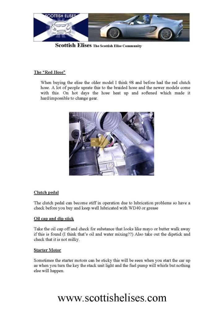

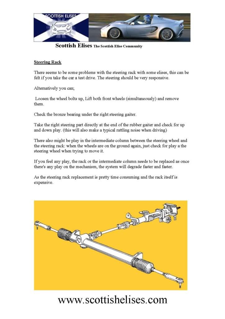

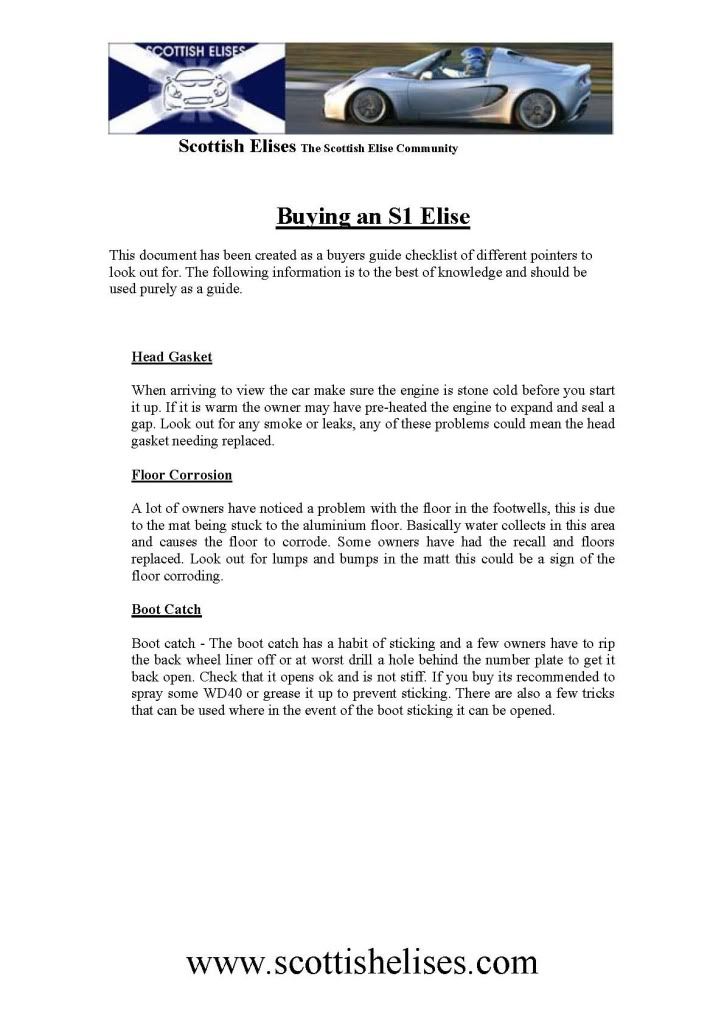

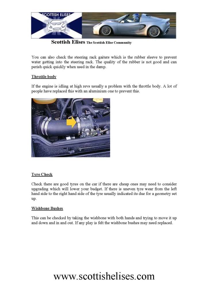

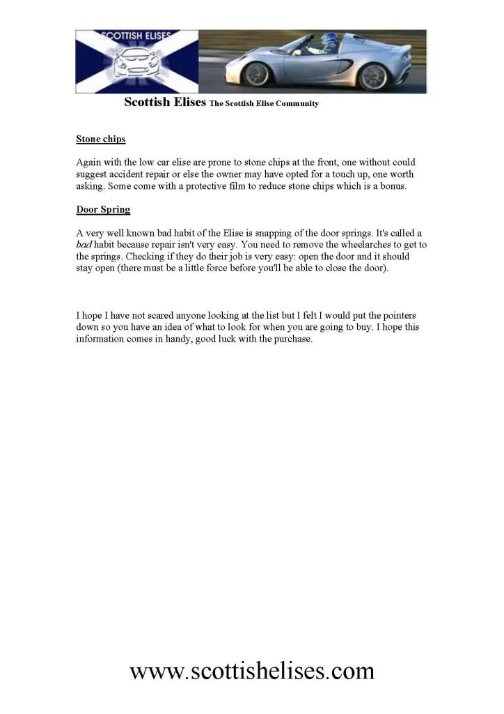

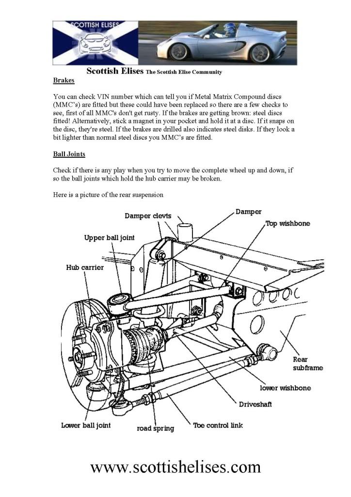

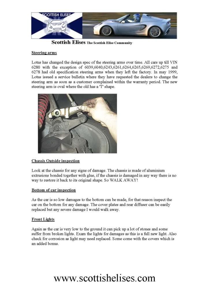

Please find below sheets to help when searching for an S1 elise :thumbsup

One thing I noticed though was the last sentence in the section about brake discs doesn't quite read correctly. :wink:

If anyone has any issues I can take it down, it was just a helping hand for people looking for an S1 as it gives a heads up on what kind of things to be looking at when buying an elise. The only reason I put Scottish elises on it was if it was used or passed on that we would increase members on here and that's the whole point of the forum IMO.... To have a large diverse group with a common interest. The reason I posted it was it's easy to send a link to any newbies to let them have a look. I apologise if it has caused issues and can delete it if it's a big problem. No I did not ask permisson nor did I even think as they are just general pictures from various sources which I found when I was researching and I collected them and made the one document. I really didn't think it would be an issue as I am only trying to help other not gain any profit. Most of the stuff is diagrams and pictures of bits of the elise not pictures I would have thought anyone would have any issues using because they clearly have been used for the purpose intended.
