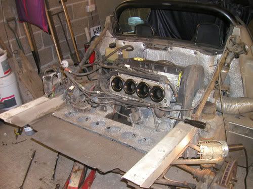

Clam off then. Undertray off, get the rear of the car in the air with axle stands and then get the rear wheels & liners out. That's the easy bit. The rest of the job wasn't too bad actually, but I can see how it could be a complete pig if you had more duff bolts than I. Tthe two rearmost bolts in the boot (I have the later fibreglass boot) were spinning, so required use of mr angle grinder, but the others came out fine. 4 in the bootlid gutter, 4 in the door checks, 2 behind the seatbelt mounts and 2 to the front of the rear wheel arches. Then unscrew the fuel cap filler surround and poke the filler through the hole...
Next it's a test-lift to make absolutely sure there's nothing else holding on the clam and it's off and up against the wall.

Clam off!

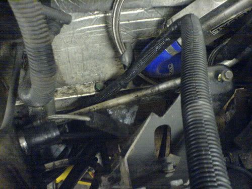

Shot of location for remote stat (for Baggy)
