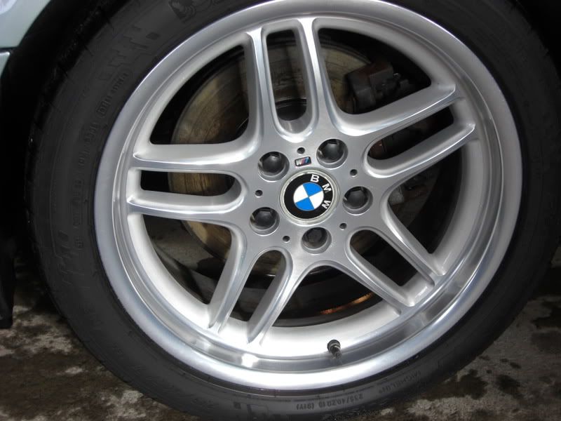

Re: Rusty wheel bolts
Hammerite works Ok but if there's enough room round the bolt to fit a cover then that might be a way to go as shown in the following pics it's my young lads BMW but you get the idea.........and BMW don't supply them they come either from Vauxhall or Volkswagon
.......the bolts shpwn just get post in the holes but with the coversw it just gives that finished look but don't use anything like Megs Wheel brightener as that can dis colour plastic which is what the covers are!
BEFORE
AFTER
Just a thought
331
BEFORE
AFTER
Just a thought
331
