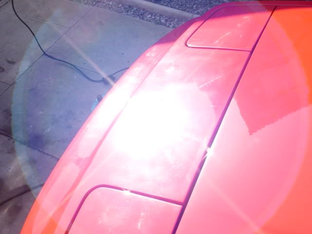

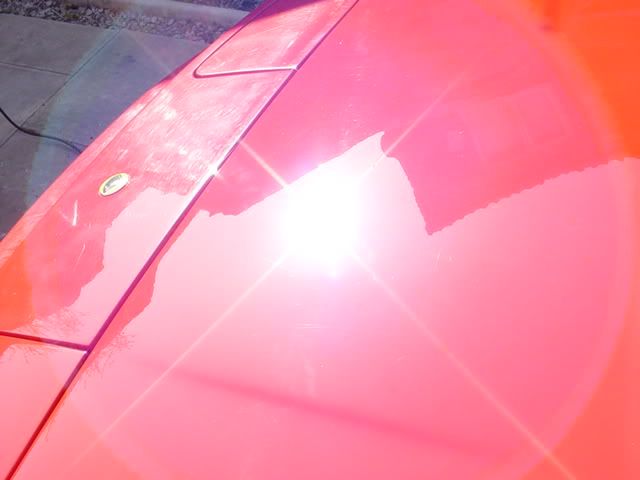

I got the DAS6 kit that T_T recommended for the Esprit and have had zero issues with it, its a surprisingly well built bit of kit with little touches that make it even more appealing (Like spare motor brushes included in the kit). The main problem is time! I went for 3M synthetic sealant rather than a organic wax as it lives outside and I wanted a tough durable finish I could ignore for a while.
It's easy enough to do, even for someone like me more in tune with impact engineering, and the results are great! Follow the guides on Polished Bliss's site.
One thing that does upset me slightly is that you do all the hard work and you will see your car is now properly stunning but you will be tempted to leave half a panel so you can point to it and say 'look how bad it was!'
The best thing I have found is the Esprit now glows in low lighting/twilight (No it's not on fire) as the paint is now so much better.
SWMBO thinks I'm mental but can appreciate the difference it's made.
Do it.
Rich
EDIT: Still need some pics to enter into PB's competition! It's getting papered (ie washed) again in time for the Lytham Classic show in a couple of weeks so will get some then.
Sh!t camera but you get the idea:
