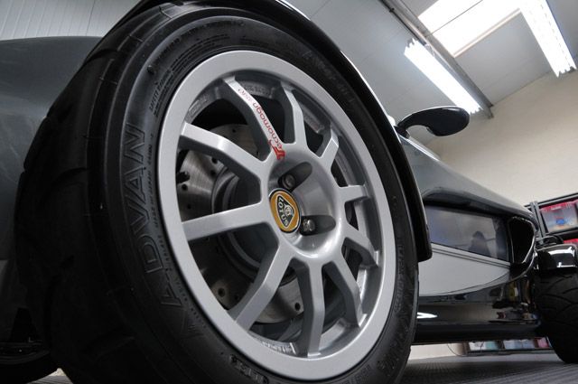

These were cleaned with Gloss-It wheel gel, Tardis and then a bit of Iron Cut (pictured below doing its thing):
They were then thoroughly dried with the Black Baron, given a wipe down with IPA and then sealed with Nanolex:
The suspension components were all cleaned up and protected with Werkstat Prime Strong and the metal of the hubs were given a spruce up with Raceglaze Alutec:
Before:
After:
Wheel bolts before:
After (again with Alutec):

And wheel back on with the tyre dressed with Gloss-It Signature Tyre Gloss:
Including the inner wall...

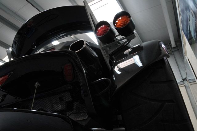

Tailpipes were polished with Brilliant Metal Polish:
A few more bits were removed to help with polishing later on:
Carbon on silencer before:
After 2 hits with 3.02:

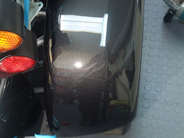

Rear valance before:
During with 85RE:
After:

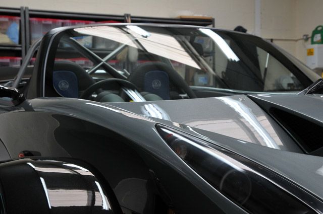

Once the lights were re-fitted I got to John to apply Aquartz to all the black parts of the car throughout. This left a subtle but noticeable difference, the one on the left hand side has been done, right side untouched:

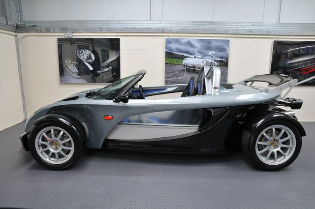

Once all the correction and interior etc were done the car was given a full IPA wipedown and protected with Nanolex Professional:
The Glass (what there is of it :lol:) was done with the cleanser and sealant:
And now let’s move on to the afters :)
