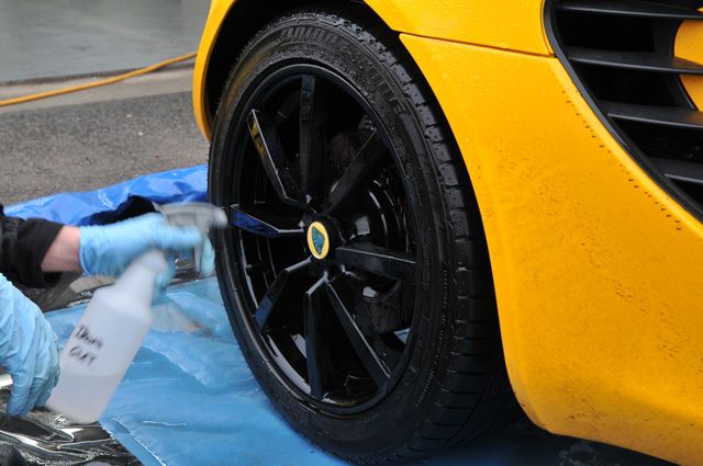

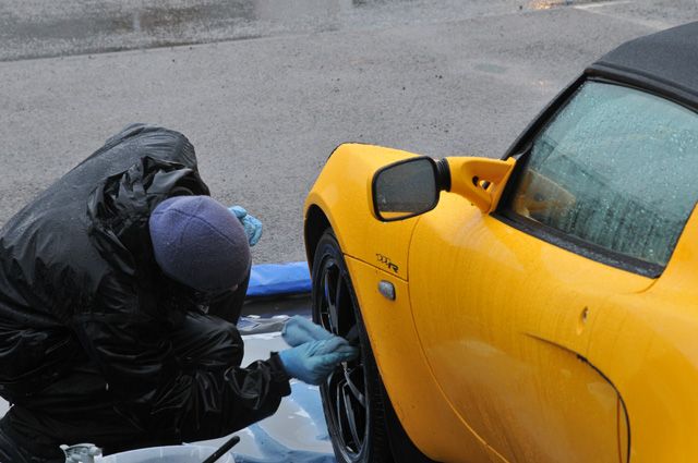

Pre rinse of the wheels, tyres and arches first:
Then out with the Wheel Woolies and Raceglaze Brushes after the wheels had been sprayed with R222 wheel Gel:

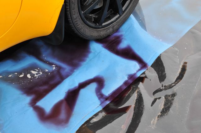

Iron-X was then sprayed on to remove what was quite alot of contamination:
With the wheels being black it didn't show up too well on camera but as you can see on the ground, quite alot of purple started to bleed out!

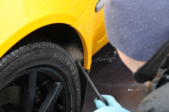

Once that had been rinsed off I applied Meguiars Super Degreaser to the tyres and arches and agitated with a brush:
Then rinsed again:

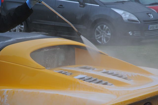

Meguiars APC through the Foam Lance at 60 degrees was used to foam the car:
Rinsed off at high pressure after a few minutes:
The only downside to using hot water in the colder months is all the steam!

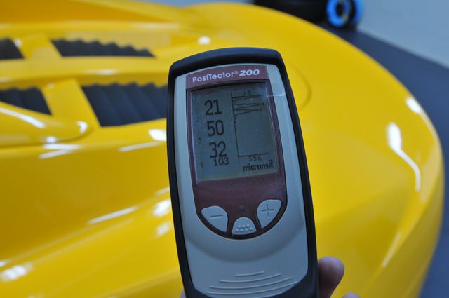

Clark then took some paint readings with the composite gauge to make sure there weren't any really thin areas:
On a whole the car was nice and healthy showing around 20-35 microns of clear coat:

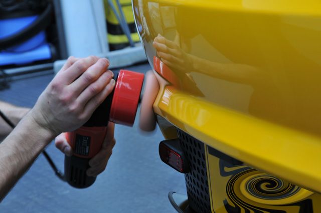

As this was an enhancement detail we weren't aiming for full correction but just a good improvement so we went with Meguiars 205 on a Tangerine Hydro-Tech pad with the Das-6 Machine:
This gave very good results with just the deeper marks remaining:

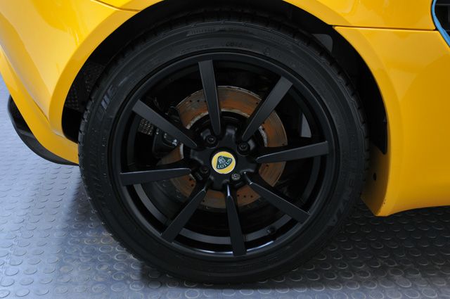

Meanwhile, Clark had been cleansing the wheels with Swissvax Cleaner Fluid and protecting with Swissvax Autobahn:
Before:
After:
Tyres were dressed with Swissvax Pneu.

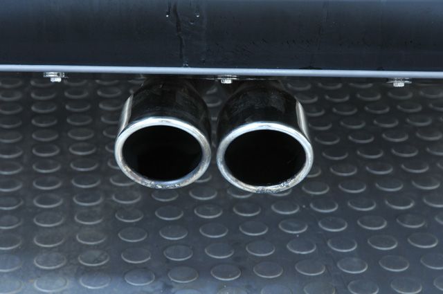

Swissvax Metal Polish cleaned the tailpipes up nicely:

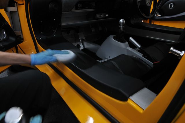

I then turned my attention to the interior:
First I went round all the nooks and crannies with a Swissvax Detail Brush:
Then thoroughly hoovered:
All surfaces were then wiped down with APC...
...Before cleaning the leather with Swissvax Leather Cleaner and Brush:
Followed by Swissvax Leather Milk:
Interior glass was cleaned with Swissvax Crystal:

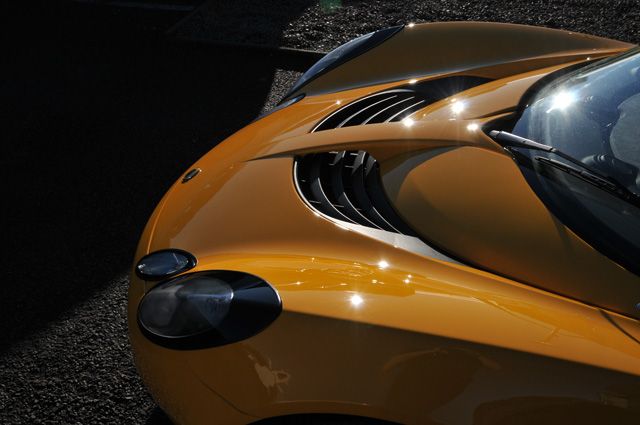

And here are the finished results:
