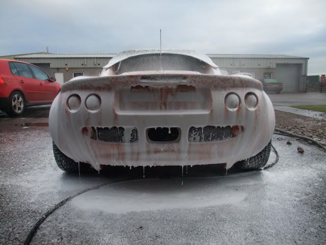

The wash stage was straightforward and followed our usual methods. The roof was power washed, then sprayed with Meguiar’s APC and scrubbed with a Meguiar’s the car was moved inside for claying which revealed surprisingly little contamination.
Everyone loves a foam shot
