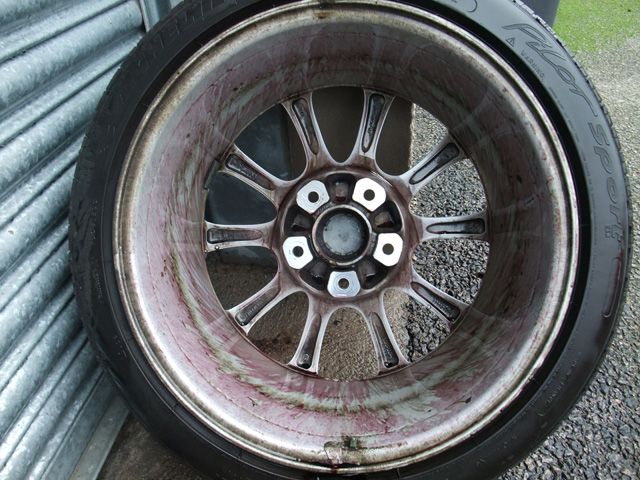

As with any detail I started with the wheels, these had some really stubborn stains on the inner rims so I decided it would be quicker to just remove them:
I gave them a good pre rinse and applied Wolf's Decon Gel and left them for 10 minutes while I gave the arches a quick going over:

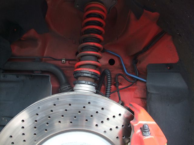

After Auto Finesse Citrus Power (10:1):
The Decon Gel had done its thing by now and was ready to give a quick agitate and rinse:

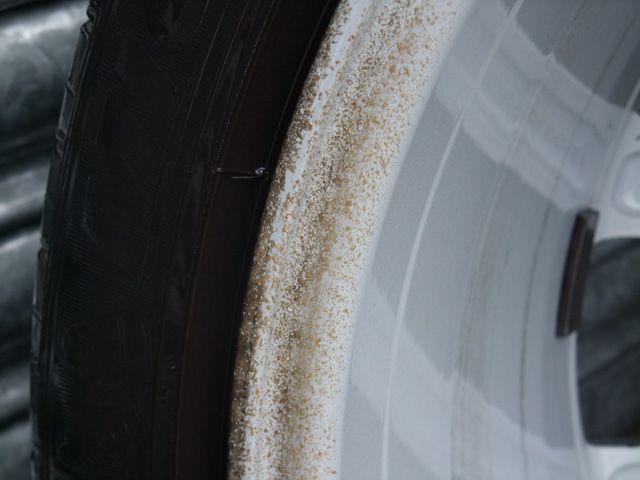

After rinsing there was some minor tar spots and transport wax type overspray, this was easily removed with Autosmart Tardis:
After being dried off with the Black Baron (or Metro Vac as it's now called) I applied a coat of Swissvax Autobahn:

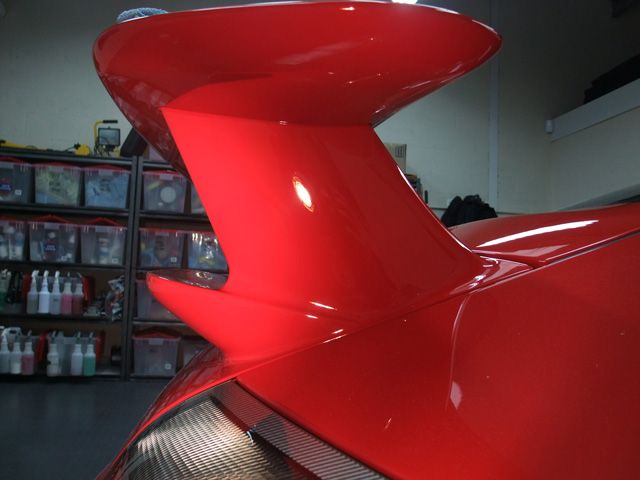

After collecting paint depth readings it was time to start polishing. I'm not going to make out like the car was riddled with massive deep scratches everywhere as it wasn't - but it did have a fairly even distribution of intermediate defects with the odd deep one here and there. Red is a nightmare to capture swirls on camera but this was about as good as I could get without wasting too much time:
The GT3 badges were removed from the engine cover to get at the defects behind them:
The plastic panels such as the bumpers, side skirts, rear wing and engine cover were corrected with Menzerna 3.02 & Lake Country foamed wool @1800rpm's. I then followed up this step with a Meguiars V2 Polishing pad and Menzerna 203S @1500rpm's leaving just the final stage of refining later on.

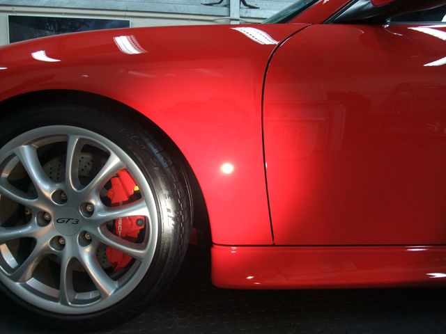

With the paint fully corrected & prepped it was time to protect with Swissvax Crystal Rock:
This was applied to the whole car and left while I sealed the glass:
Amongst all the little details that remained the tyres were dressed with Swissvax Pneu, Tailpipes polished with Auto Finesse Metal Polish and the engine bay was protected with Swissvax Motorshine (this was done before polishing so any light overspray was removed).
The interior was given a quick going over but it didn't need much, just a good dust down and hoover, wiped down with a damp MF etc and glass cleaned with Auto Finesse Crystal:
Back on the exterior now and all that remained was a final wipe down with Auto Finesse Finale and jobs a good un' :thumb:
As already stated, the car wasn't exactly bad to begin with so it was nice to be able to pretty much fully concentrate on the paintwork.
Due to the weather being proper dull I had to use the Sun Gun to replicate some sunlight to try and at least give an impression of what the final finish looked like:
