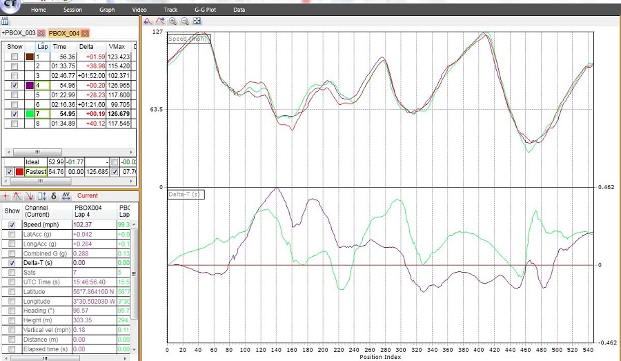

Final *runs* were better but really struggled with the dirt at the hairpin I think. Lap data is showing a theoretical best of 52.99 from the final :O
Red - in 54.7 in Qualy - slow MacIntyres and Chicane
Purple is first run in final, slow over duffus with Russ
Green in second run in final - messy!!
