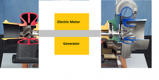

As I read it they have been very clever in their design and have split the turbo and added a motor/generator in the middle
excuse my shoddy graphic :D
Allowing them to either harvest energy or use it to spool the turbo up/power the wheels. and it keeps the hot parts well away from the bits you want cool.

It's not just the electric motor/generator in the middle, it's the whole engine!
In a previous discussion offline, Woody pointed out the similarities to the layout of a jet engine... cold air goes in the front end, gets compressed, gets burned in the middle, then gets used (again) at the back, with a shaft through the middle joining it all together. When he put it like that, it sounds like such an obvious evolution of the turbo'd engine layout, but I really think it's a bloody impressive step to take something so well established and rethink it completely.
The list of benefits is so big, and the technical difficulty seems to have been overcome, which is amazing. Genius idea, brilliant execution.
Very exciting stuff, and definitely something we'll be seeing in road cars in years to come. Amazing what happens when the rules get shaken up.
