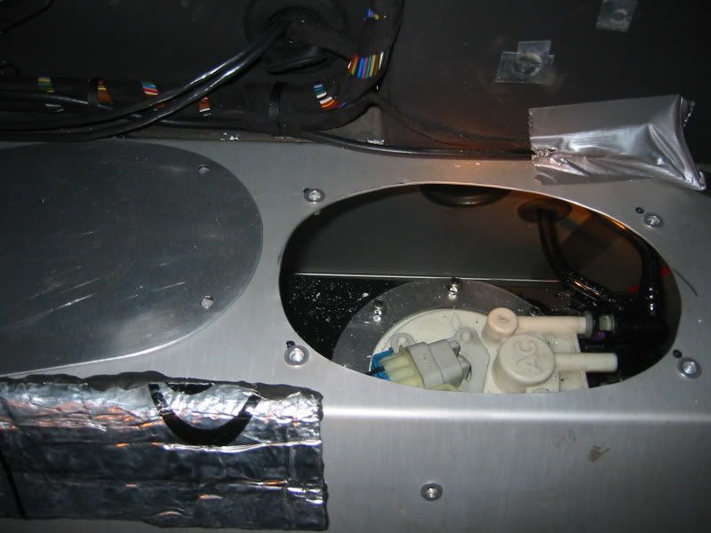

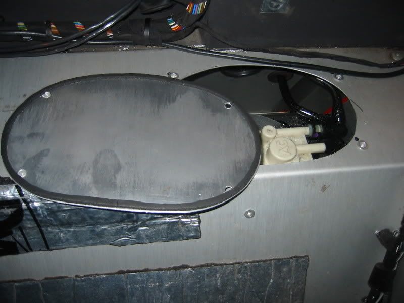

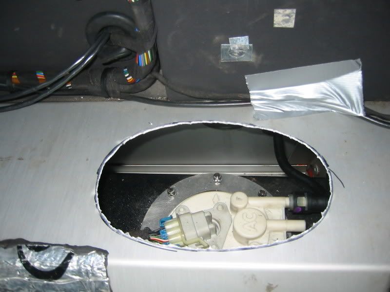

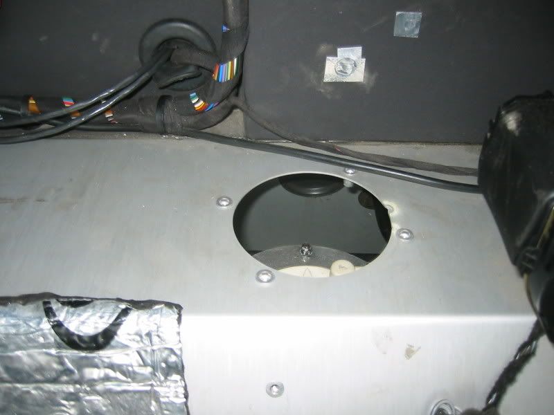

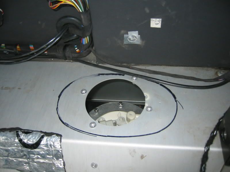

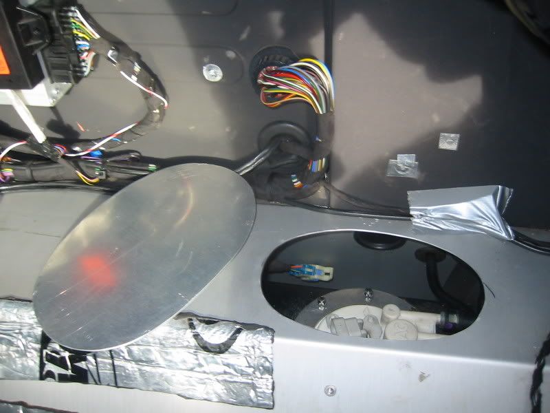

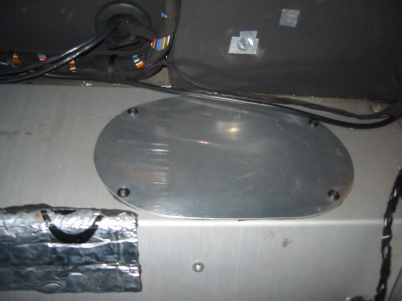

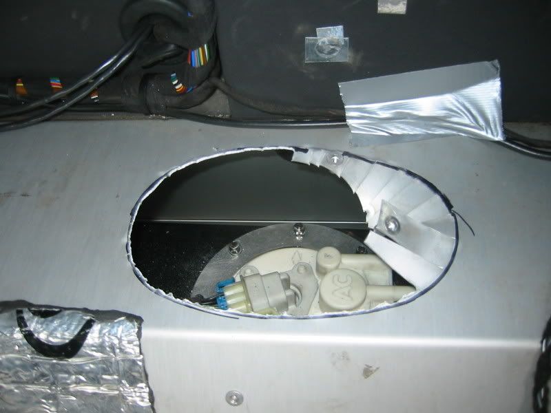

He is going to cut and enlarge the fuel pump access hatch rather than drop the tank, a process that Uldis has already pioneered.
