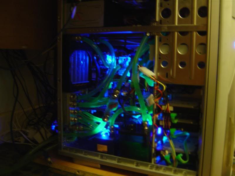

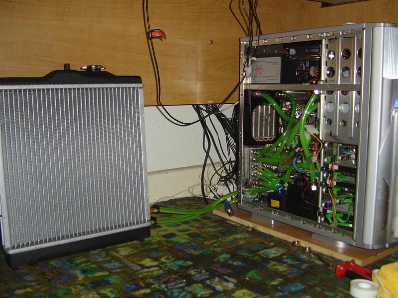

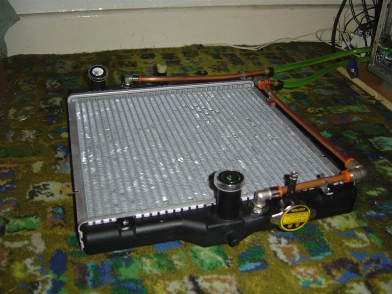

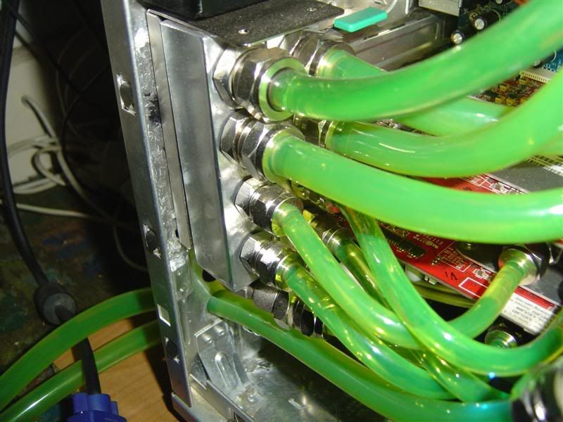

One of the guys on the vx site had a bash at the water cooled idea, so he fitted a radiator from a Honda civic :shock:
evocarlos wrote:right here's how it stands now
back side or rad where fans will be going
close up of the manifolds i made
ohhh illuminated
Image[/quote

It would work better if he ran a fan on the rad and a compressor as the current setup will only allow it to run at room temp. he could try running it on meths fitting an expansion valve and a compressor, it wouldn't work as well as a refrigeration gas (you need to be qualified for that& R22 is good) but should work enough.
rad would be high pressure side, case would be low pressure side
It may frost up that could be a problem :(
I have taken that to far haven't I ? :oops:
