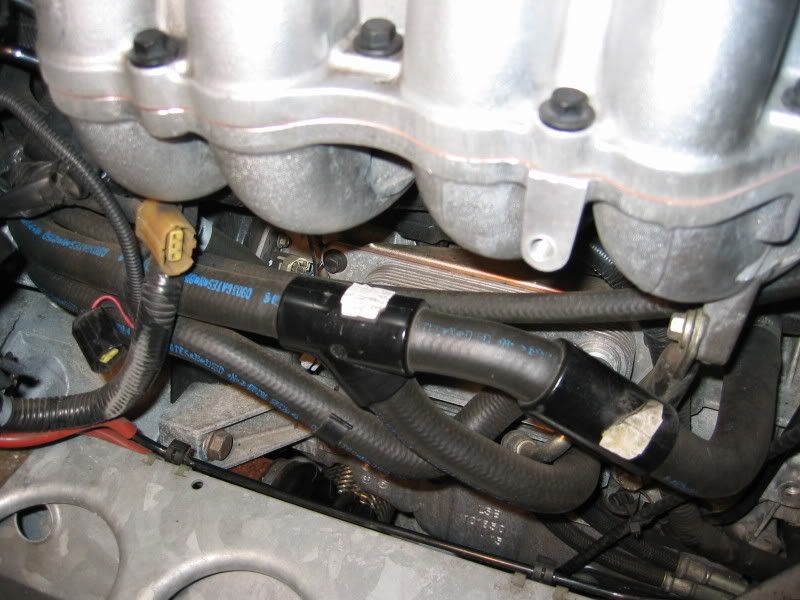

Could not wait till tomorrow.
There are two oil hoses coming from the cooler ( which I never knew was there ) going down towards the oil pump below the cam belt area. Must have been one of the hose fittings that was corroded.
Threadf merge see : http://www.scottishelises.com/phpbb/vie ... php?t=8703
