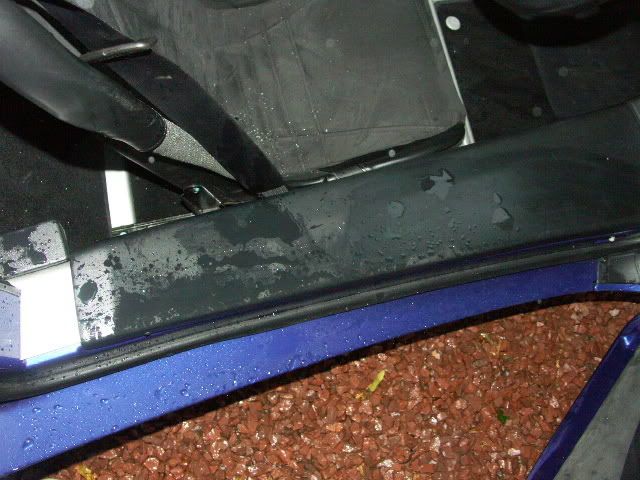

Post by Trap 125 » Sun Aug 05, 2007 6:43 pm
There is a gap between the top of my window and the rubber it is supposed to meet. Is this normal? The car was sat out in the rain today and the water made its way through the gap and in to the car. Anything I can do or is it just part and parcel?

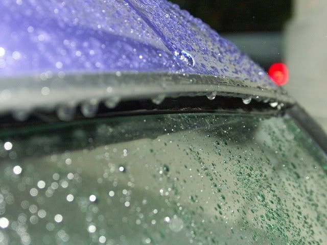

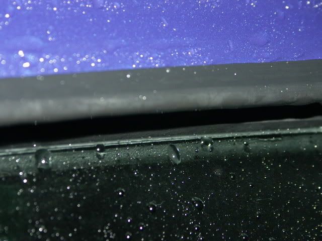

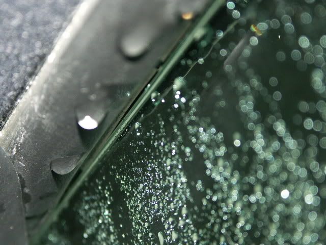

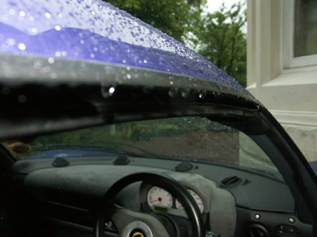

Post by Trap 125 » Sun Aug 05, 2007 7:50 pm
Here are some pics. Its hard to see but there is a gap where the top of the window meets the rubber and the water is pissing in. :cry:

Post by Stewart » Sun Aug 05, 2007 8:07 pm
Don't think it should be that bad. You may need to have the windows adjusted so that they wind up a little further.
I have a S1 and have noticed that the windows wind up a little further when the door is open than when it is closed. You could try that in the meantime.

Post by meatball » Sun Aug 05, 2007 8:17 pm
As said above ........the door card comes off and the height the windows raise can be adjusted.
The angle of the windows can be adjusted by the 2 screws on the inside of the door that are visible when the door is open.
Not a big job but difficult to explain on internet.......
I'm sure Robin n co will explain better than me....failing that Ali SLS will do it in 10-20 min????
Meantime..........some tape to seal up while car is parked????
Post by GregR » Sun Aug 05, 2007 9:18 pm
before going to that hassle, try opening the door and putting the window up then shutting the door. Sometimes part of the roof prevents the whole thing close snugly so putting tghe window up when the door is open sorts the problem :)

Post by Edin430 » Sun Aug 05, 2007 11:13 pm
Orrr if you want a lot less hassle - as i did with the same problem - take some double sided tape (the thick stuff thats about 3/4mm thick) stick it all the way along the seal and then stick black electrical tape over it...
No one will ever tell the difference and its all you need to fill the gap.
