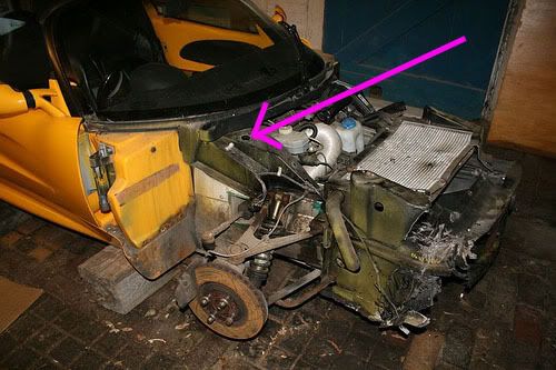

Post by jj » Mon Sep 24, 2007 7:16 pm
Robin described it better than I could, so heres a photo :D

Post by jj » Mon Sep 24, 2007 7:27 pm
The tube is probably what was holding the nut in place (you need to pull the whole thing out) as from memory, there would be nothing to hold just the nut in place (which there was, if you have found the nut).
