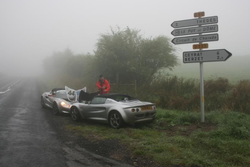

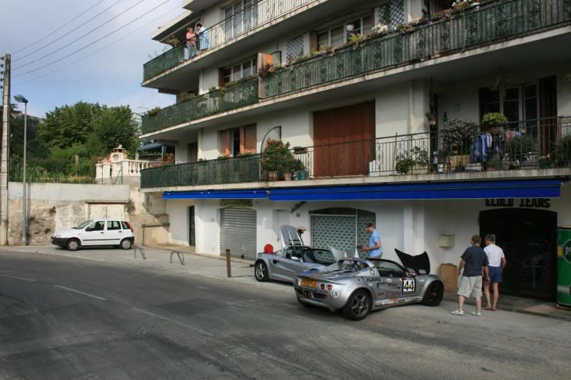

Post by Andy G » Fri Dec 21, 2007 10:03 am
alicrozier wrote:Was getting at least 1/2 an hour on FF this year but that was not fully charged (just some time on the jump leads). I think tut reckoned closer to 2 hours when fully charged.
Caught on film

Post by tut » Sat Dec 22, 2007 2:26 pm
Fergus
As Robin says, my wire burnt out at the Ring, so we had to use Ross's car in 20-30min charge up stints to get to the Tunnel.
I was running in the middle with RainEx on the screen, so no wipers or lights and indicators, and got around 1.35hr max.
