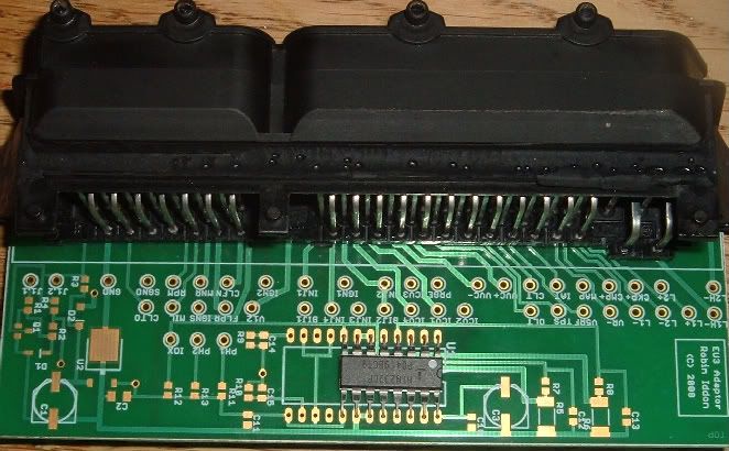

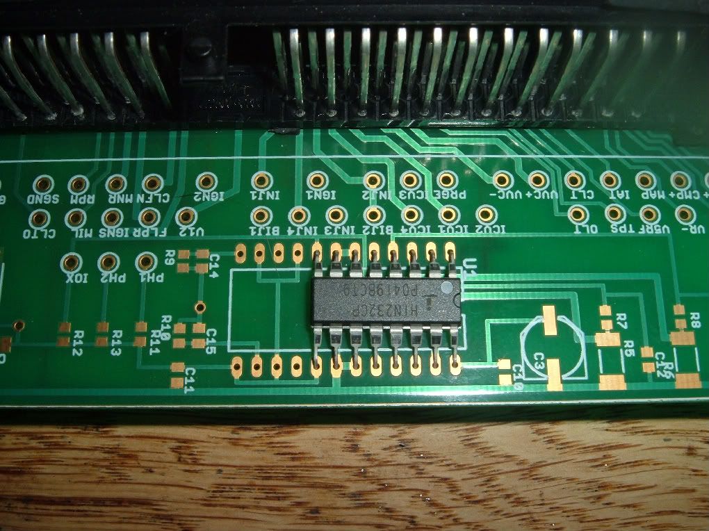

Yeah - been distracted of late to say the least (though have at least now got the S2 adapter PCBs back in and they look 8) ) the K4 connector fits (80 pins all properly placed without a drawing of the connector, so I was lucky not to make a mistake!).
Spot the obvious mistake - no harm done, just a bit of a funky mounting :-)
I'll struggle to get the EU2 interceptor PCB done and back between now and Donnie - your call on whether you want to make a big hand wired breadboard or wait for a PCB. Your cables and connectors are here in the hall whenever you need them.

Post by campbell » Wed Mar 12, 2008 10:54 pm
And the deliberate mistake (for those of us without elec eng degrees) is...?!
Looks 8) whatever the case!
So is it for diagnostics or is it for a new ECU product? Will this make Graeme your first guinea pig, sorry, customer?!
ninja

Re: Misfire, Donny, Help
Post by ninja » Wed Mar 12, 2008 11:17 pm
i think the deliberate mistake is he's posted the pic upside down so all the text is the wrong way up and thus hard to read!!!!
Post by Rich H » Wed Mar 12, 2008 11:33 pm
(The chip is too narrow for the holes :thumbsup )
Post by robin » Thu Mar 13, 2008 12:13 am
RICHARDHUMBLE wrote:(The chip is too narrow for the holes :thumbsup )
Ding. Get that man a clapped out porsche ... no wait, he has one already :-)
Campbell, it's just an adapter to allow a non-Lotus ECU to drive the car without chopping up the loom. I have the MegaSquirt built, but there are still some incompatibilities to overcome before that will work. I really need to do the same thing for the EU2 engine (i.e. yours and Greg's ;-)) and I am working on it, honest, just slow going at the moment.

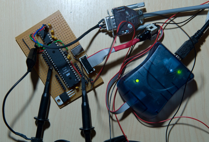

fd
Posts: 883
Post by fd » Thu Mar 13, 2008 1:07 am
robin wrote: I'll struggle to get the EU2 interceptor PCB done and back between now and Donnie - your call on whether you want to make a big hand wired breadboard or wait for a PCB. Your cables and connectors are here in the hall whenever you need them.
I'm just waiting on some compoents and will be able to make a double layer job from vero . . . digital on the bottom, analogue on the top . . . bottom is up and running and the code is ready, PC end is good enough to debug things also . . .
I'll lash up the loom part so it's reusable . . . we can hack this to validate the crank pos side of things before comitting to a specific board . . .
I had it streaming diagnostic data from home over t'internet to the office at lunchtime today . . . remote engine diagnostics are nearly here ;-)
Post by robin » Thu Mar 13, 2008 9:54 am
Excellent - if you get enough working between now and Donnie, then if you're up for it I'll take the system down and we can apply to Graeme's car to see what's what :-)
