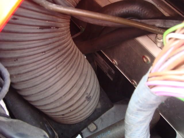

OK took these pics with the passenger side panel off,
As I have no knowledge of cars I need to know if this pipe is the feed for the air vents, to me it looks like it.
If so I reckon I could stretch some tights over it in order to cut down the dust etc
bottom
Top, where the pipe meets the dash?

Pics look like the right pipe - so if you can pop it off you can try the tights trick.
