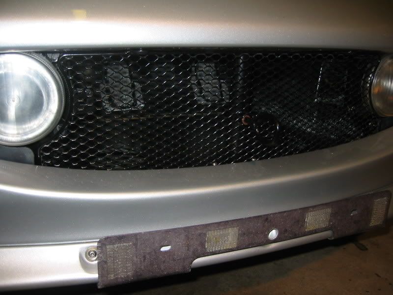

This does not reduce the airflow a bitm remember the Elise/Exige's nose is a very high pressure area.
And there is no heating element, the heating matrix is heated with coolant from the engine, it is in fact the bypass circuit when the thermostat is closed, so if it's not used it's at coolant temp anyway.
BTW, this pic was taken before TT 2005m when I damaged my nose and crash structure. But the new one they installed has a similar mesh fitted from factory (although uglier, with rivets and steel, not alloy like I did)
