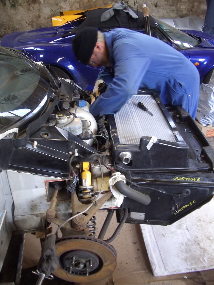

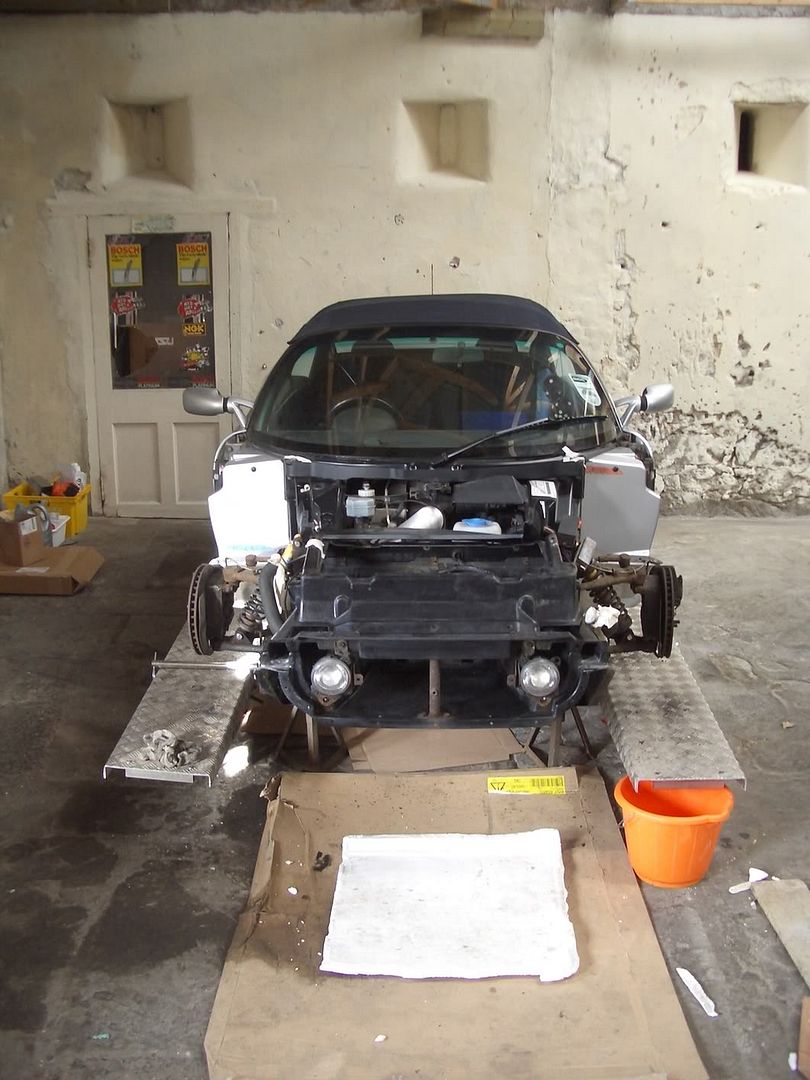

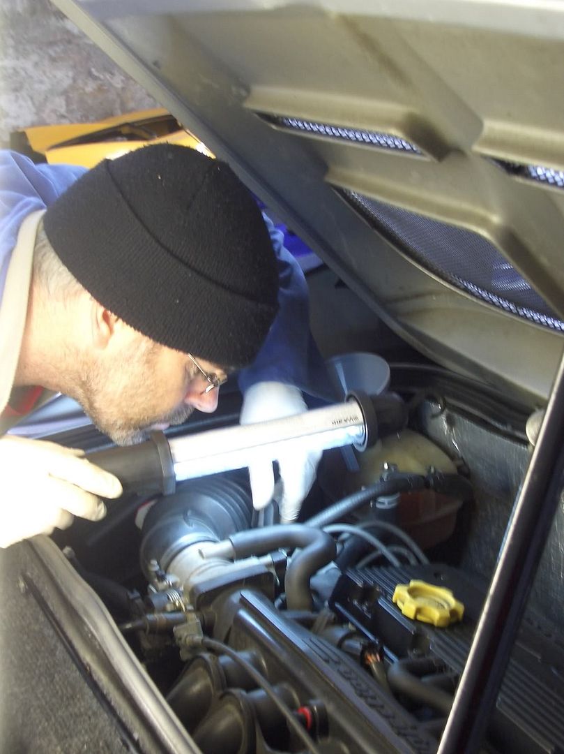

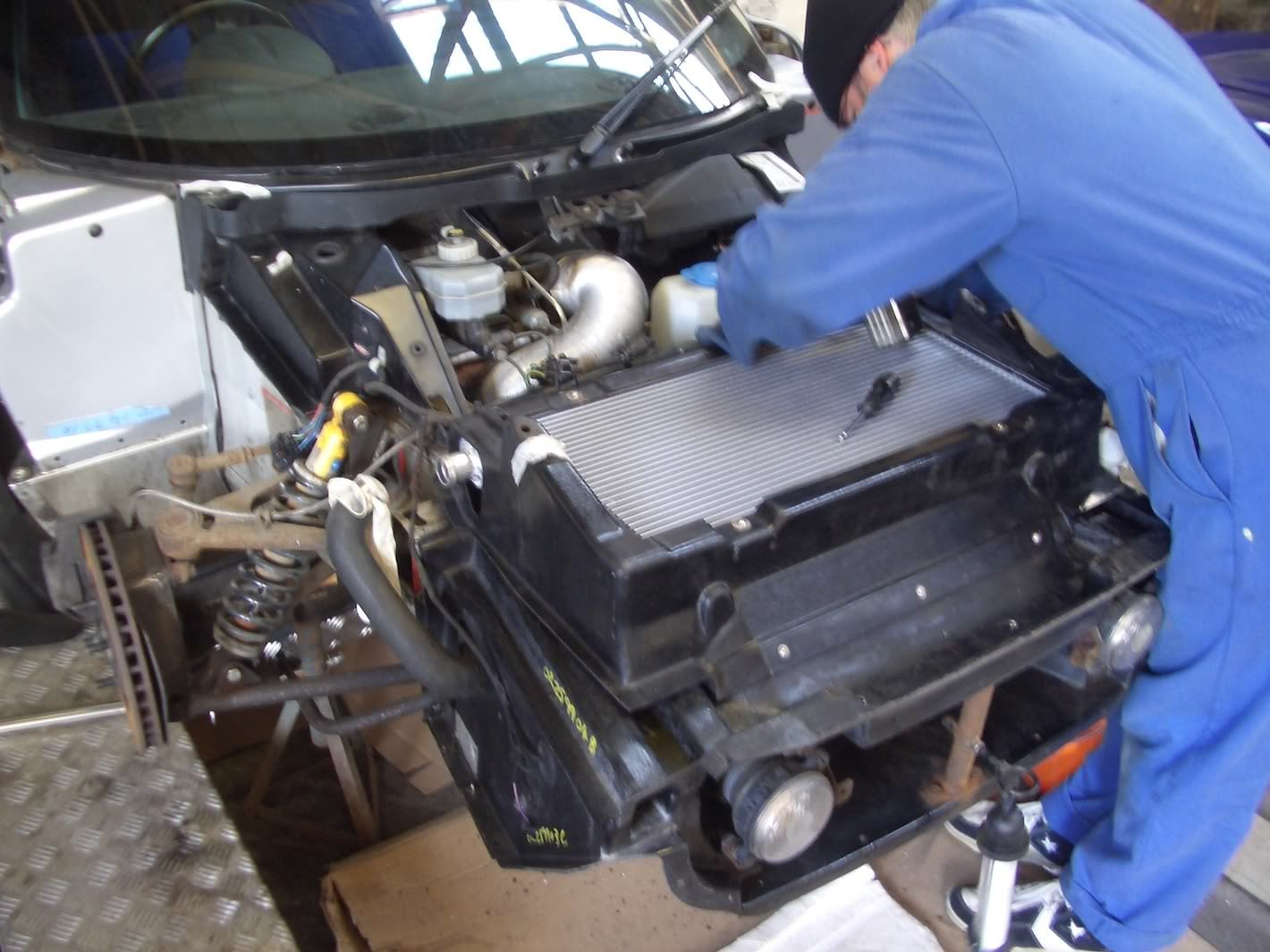

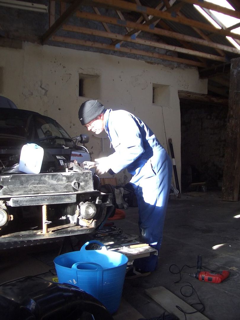

Well we finally finished off UJI yesterdya. A few minor things left on the to do list. Thought I would post some pics taken when breathers were needed from rounded hex bolts.

Brilliant, Sanjoy...some of those are priceless for caption comps I think!
A couple even infer that I know what I am doing :shock:
Really appreciate the pictorial record, actually.

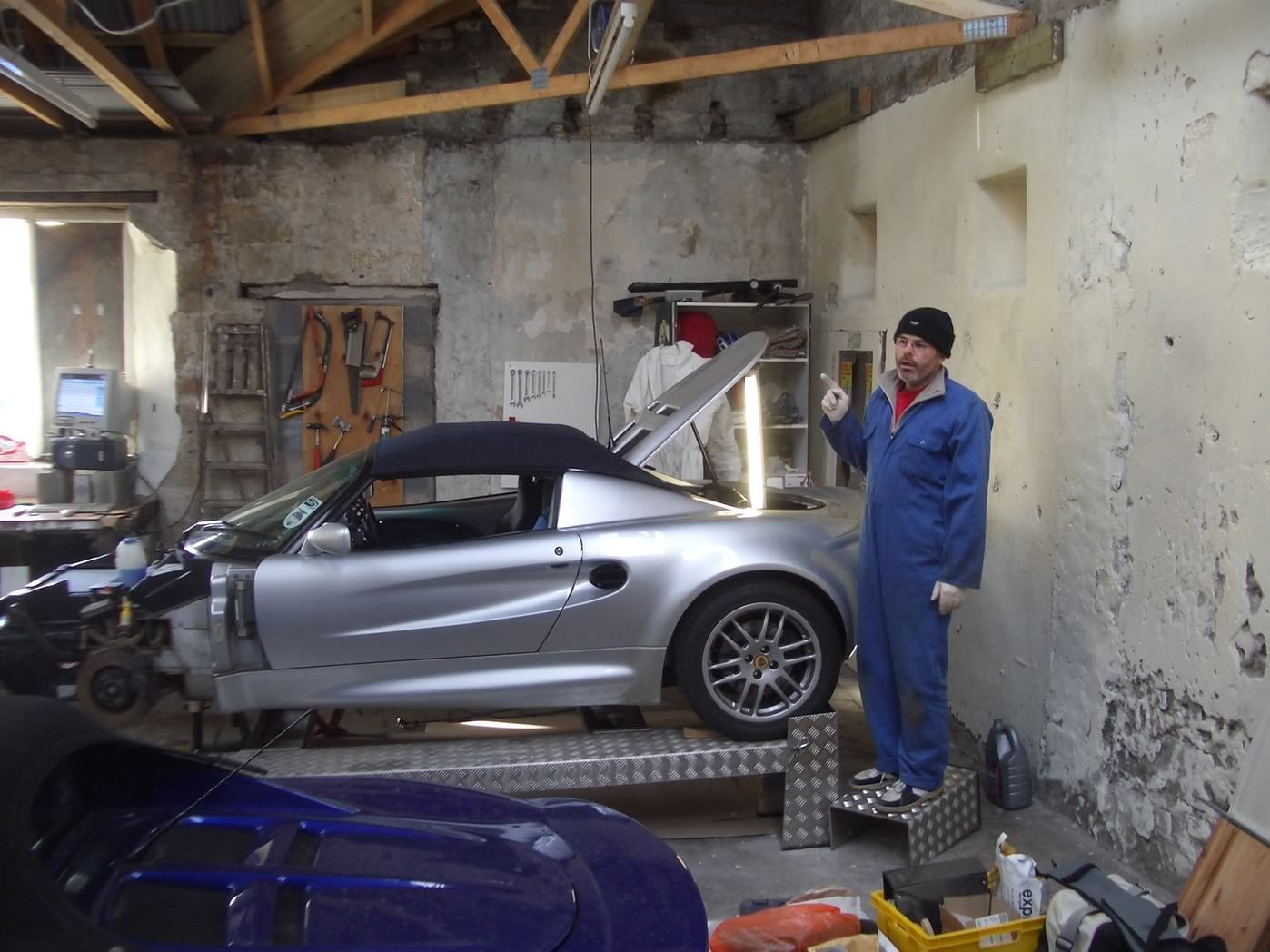

Campbell:"Hey, Sanjoy! I've found your lightsaber..."

Priceless, Ferg, nice one

Halloween in the Garage - the headless mechanic puts the finishing touches to the cooling system as the ghostly apparition that once was Sanjoy looks on......

I thought compo from last of the summer wine was dead.

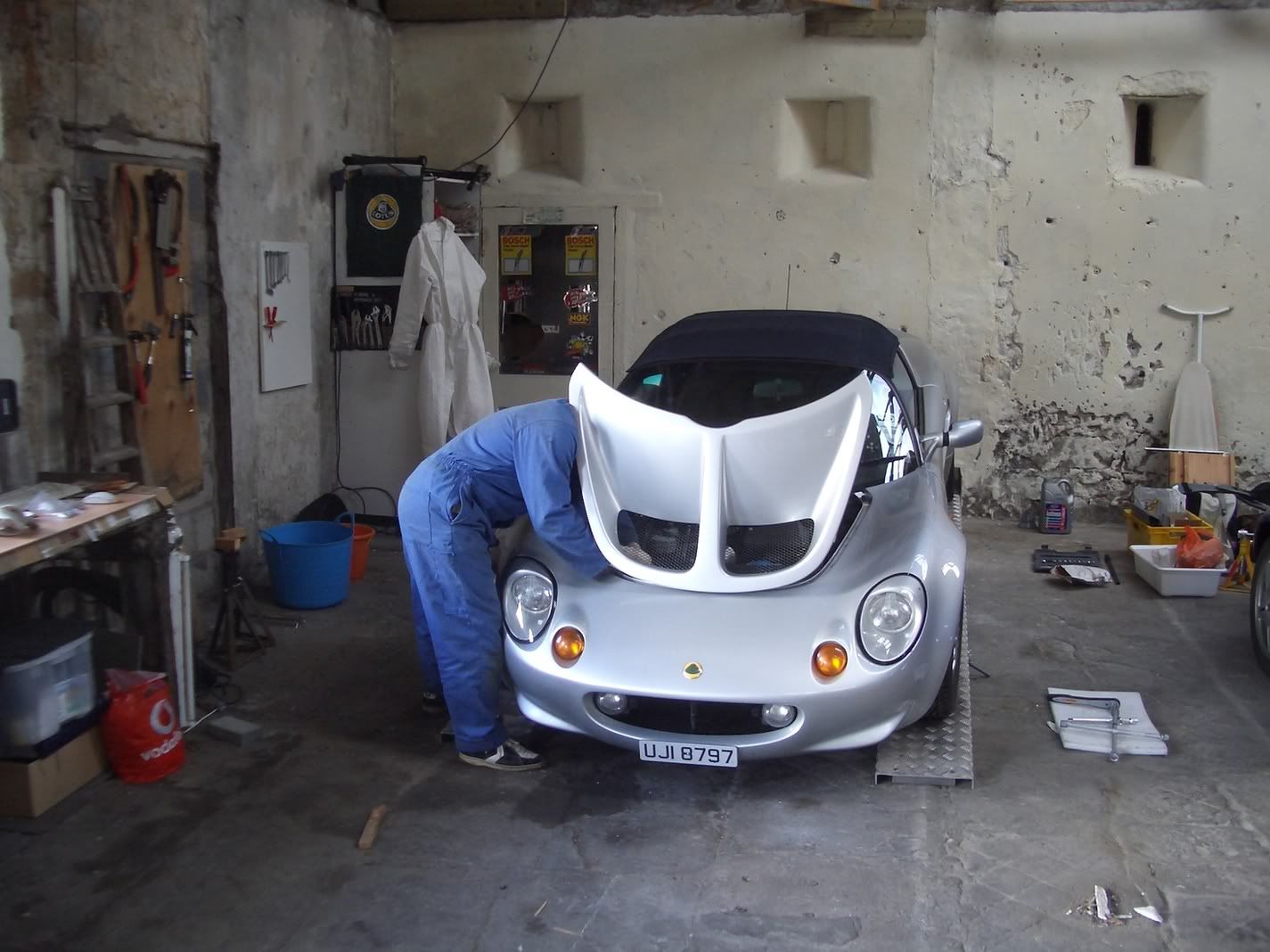

- removed the front bonnet, then drilled out the one remaining rivet holding the hinge to the front clam :roll: If only this had shown up while the car was marooned at Sanjoy's...typically it started to fail once the clam was all back on and I was ready to drive away. Anyway, got the "hinge" out...another "let's use a bolt as a pivot" special from Lotus, come on guys. Lubed it up as best I could, then re-installed using bolts this time (even though I am now King Riveter after the radiator fan fitting kit stuff we did...!) Refitting and re-adjusting the bonnet to the hinge is hilarious for one person, mind you. Get an assistant if you ever have to do this. Same goes for adjusting the stiker pin for the bonnet latch.
