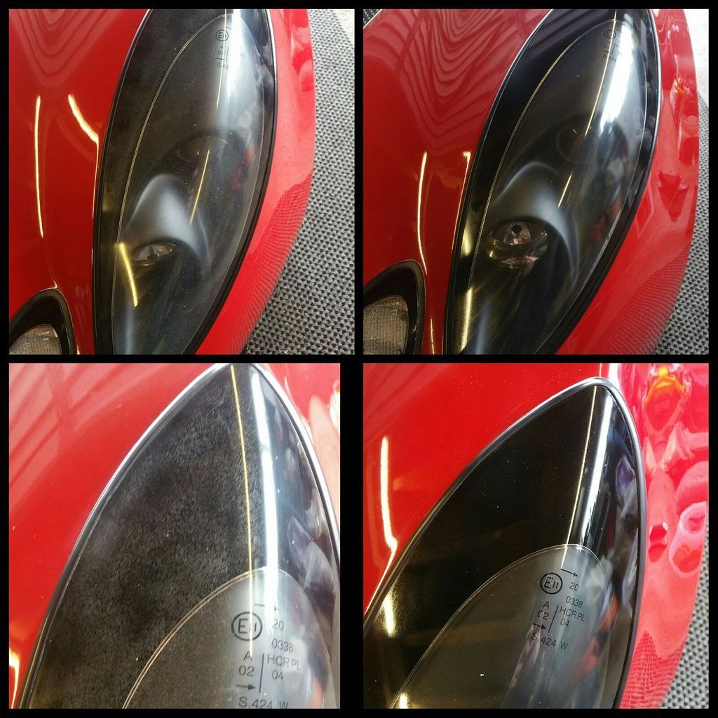

Thanks Graham. Apparently to cut the previous Uv protected layer back he had to use the harsher sand paper and use a machine buffer. The instructions just said to polish by hand and use the supplied 1000 grit.

You will have to sand with all the kits to remove the damaged top layer of the plastic, I wouldn't worry too much about not having a machine, the machine is able to do the job much quicker and with much less effort than manually doing it by hand, you can use an orbital sander providing you can get the correct grades of wet and dry for it. That said manually sanding is safer as things go wrong a lot slower.
It you have a look on YouTube search "wet sanding headlights" or "restoring headlights" you can usually find a pretty decent informative video, Junkman2000 and ammoNYC are good if you have oodles of time to kill but there will be other videos which show you what you are after. (avoid the toothpaste ones they are just for lightly discoloured headlights) http://youtu.be/eP1YlZJbV7s is a decent enough example. The only thing is polishing by hand will take you a bit longer but I'd depends what system and grades/polish you buy :D hope this helps!

Post by a4drk » Thu Feb 25, 2016 6:38 pm
I bought the kit as mentioned here - never used it - so its up for sale if anyone wants to buy if off me.
it came from USA & took 3 weeks to arrive
I used a guy called Steven Bryce - really good detailer.
heres what he done this morning ......
Im very pleased with it.
David
