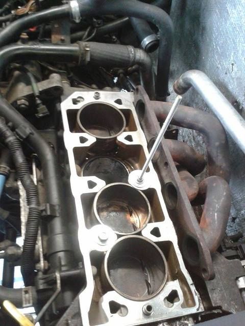

So, after what I thought was head gasket failure, I stripped my head off the block and have discovered a cracked liner ( yep, imagine the joy I felt seeing that one :x ), so now I have a liner to replace and was hoping someone could advise me. do I need to remove the whole engine? and how do I remove/replace the liner? also anything else I should know would be appreciated.

I think, you should be able to keep the engine in situ, drop the sump, unbolt the Conrod on the affected cylinder, remove the piston & rod, then the liner will come out without much effort.
You probably want to consider if you want to patch it up like that and what height that and other liners will be against taking it out and overhauling the bottom end now.

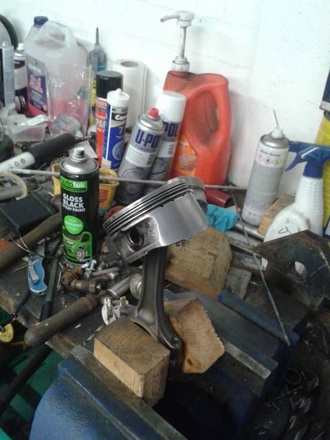

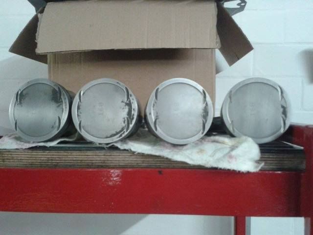

the rebuild begins with some piston cleaning, getting them ready for new rings and big end bearings.

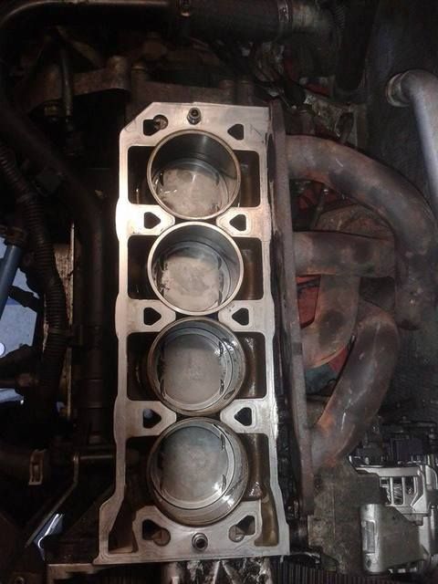

had a few hours today so managed to get some work done,
From this:
to:
and then to this:

just everything topside. did sump today.got it started an hour ago, going to bleed the coolant system tomorrow,
