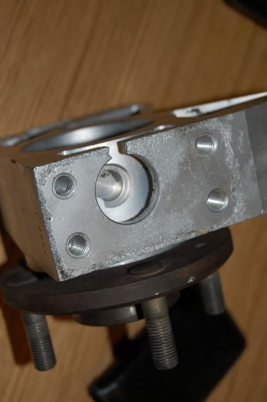

Not really a question, but i changed a front wheel bearing today, and having plastic media blasted (much gentler than grit) the hub carrier, was very surprised to see how badly corroded the alloy was around the points where the balljoint's locate.
Nothing structural, but it just makes me wonder how elises will be fairing with these ravages in another ten years time :?:

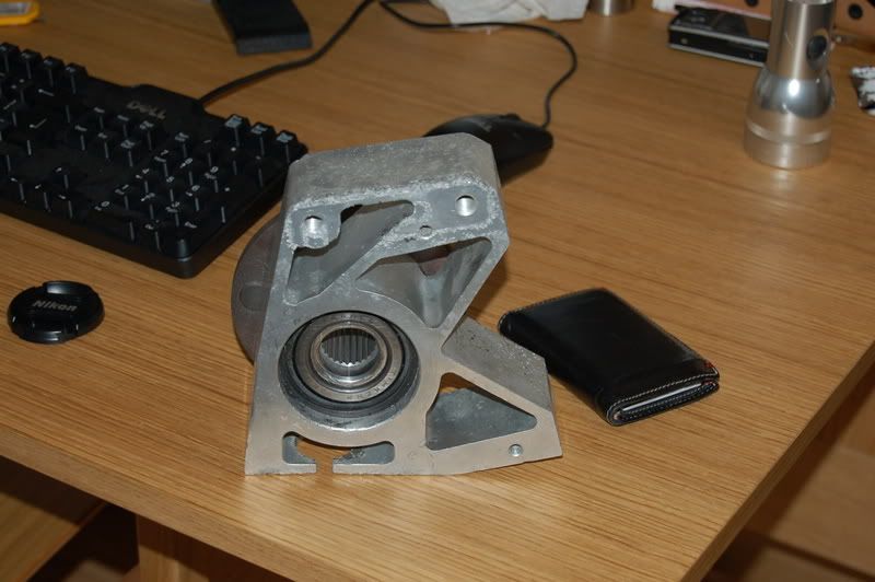

Not particuarly worried, just surprised. Anyway, the car's at my mum's, so i haven't bothered putting it back together, here's a few shots:

Post by Stewart » Tue Feb 06, 2007 8:42 pm
Yep, look just like mine when I did the wheel bearings last year. Most of the corrosion seemed to be where the Duralac has squeezed out.
