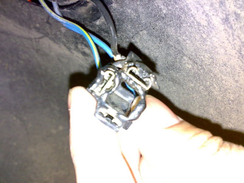

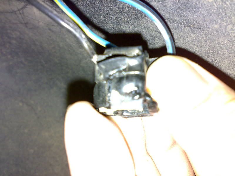

Rally bulbs do melt sh1t!
Post by Sanjøy » Sun Mar 11, 2007 8:20 pm
Post by tut » Sun Mar 11, 2007 8:23 pm
mmmmmmm.....had mine in for over two years with no probs.
Post by Sanjøy » Sun Mar 11, 2007 8:26 pm
3 years for me, only noticed as was trying to diagnose the earthing problem. I do drive for long periods with them on though, 12+ hours on occasion.
Post by woody » Sun Mar 11, 2007 8:53 pm
I had this on both lights when i bought my car. Standard bulbs though. But, then one connector was wet inside :!:
The rear of the headlamp is protected by the rubber boot, but not the actual connector.
Post by woody » Sun Mar 11, 2007 9:01 pm
forgot to say, i sorted mine with a couple of connector plugs off of a 306 soldered on, then uprated the bulbs and have had no problems since.
Post by robin » Sun Mar 11, 2007 9:03 pm
It may well be heat caused by resistance at the junction rather than heat conducted back from the higher output bulb (though I agree the heat from the bulb is significant).
Those connectors do look quite shiny though, so probably not resistance.
Post by Dominic » Sun Mar 11, 2007 10:14 pm
Some high output bulbs can get pretty hot. I was advised when upgrading bulbs in Liz not to over do it! :?
a4drk
Posts: 2222
Post by a4drk » Mon Mar 12, 2007 10:53 pm
What wattage were they?
I've upgraded to 80W
(yes ! 80W - never actually knew they existed)
(Ring - Sportsblue)
david
Post by Rich H » Tue Mar 13, 2007 9:16 am
You can get 80/65, 100/80 and 120/100 from halfrauds. I have the 100/80 fitted IIRC with no probs ATM.
