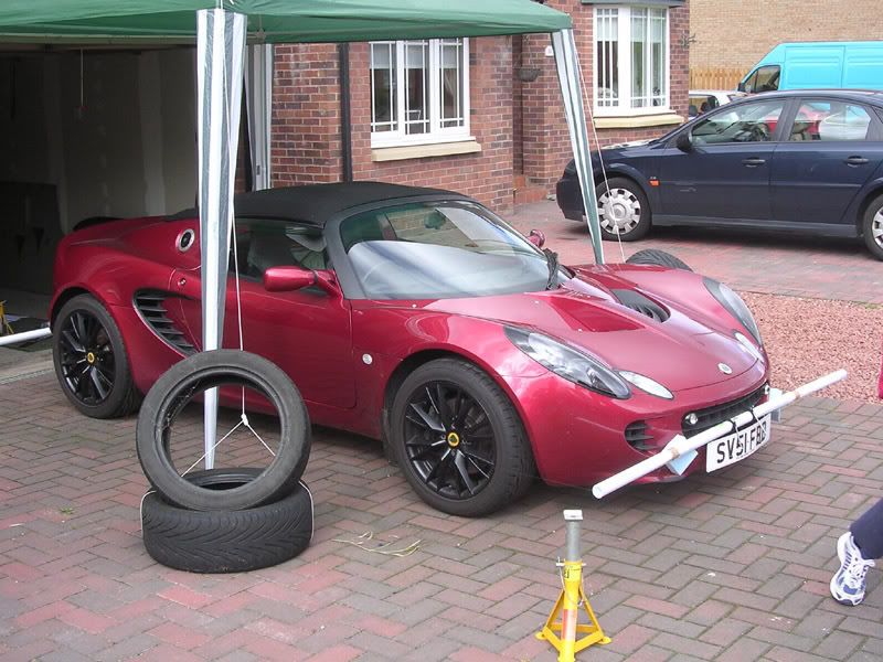

Post by dr al » Thu Apr 05, 2007 10:22 pm
DIY is possible, but it took my all bleedin' day and was SOOOOO fiddly!!
I don't think i'll ever be bothered doing it myself again!!
