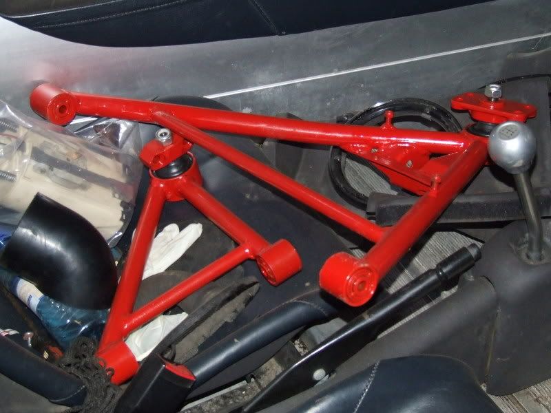

I had mine shot blasted then just painted and they come up like brand new. It was a mate that did for me and he charged me 60 quid so not out of it. Trouble is he needed them for a few days so you need to do without your car.

Post by r10crw » Mon Apr 23, 2007 2:05 pm
heres a pic of mine after shotblasting and painting.
come up really well.
Post by Rich H » Mon Apr 23, 2007 2:18 pm
Cleaner than the inside of the car too! :lol:

Post by r10crw » Tue Apr 24, 2007 7:53 am
Be fair rich :lol: The car was in a million bits at the time!
