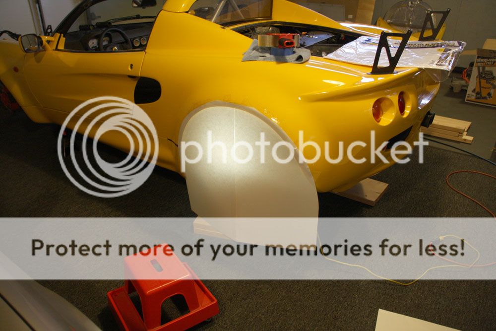

To that point, I wanted to maintain the OE wheel openings when widening the fenders/wheels 2.5". I'd need to build some forms to support the liquid foam I intend to use for sculpting. I taped some paper to each wheel well and put a light behind it. Now it was pretty easy to trace the exact curvature of each well.
From that, I created some wood forms that will serve as the base for my mold that will form the foam wheel well shape. I also created the mold support for the front lip. Note that I shaved the turn signal lights, the front k'nards, and the aftermarket front splitter.

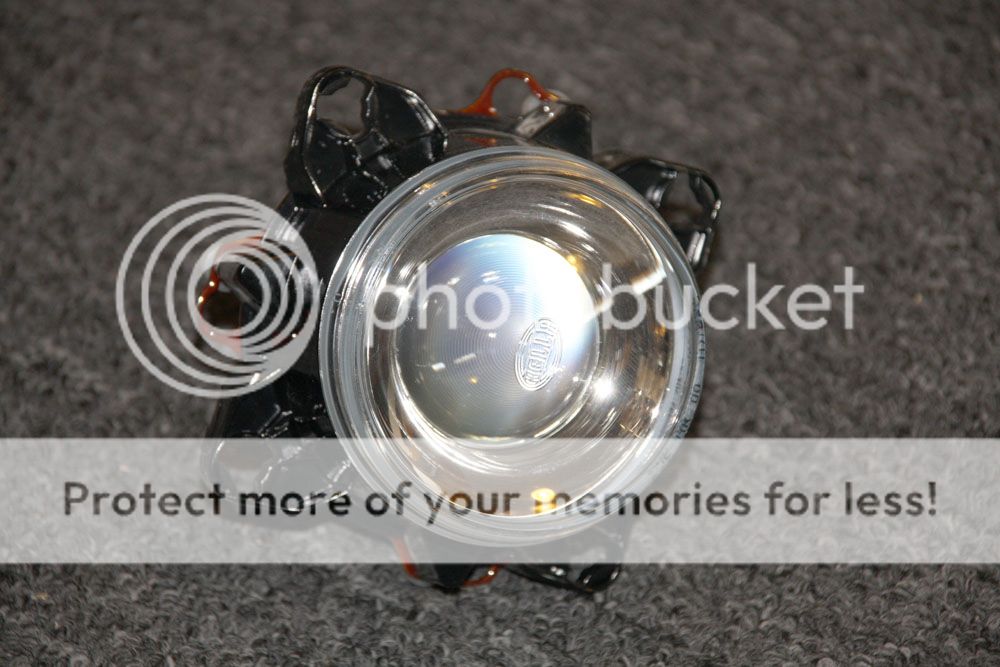

While I've not yet cut out the single headlamp to accommodate (2) HID projectors, I did order a Hella 90mm lamp for exact measurement and fitment.

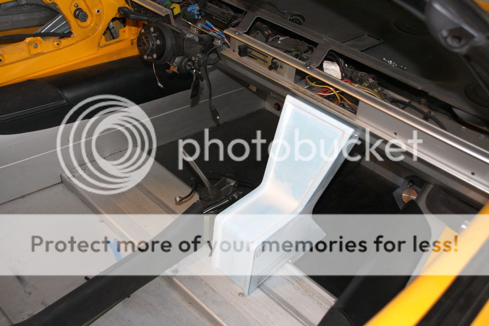

I purchased some Styrene foam (insulation) from Lowe's down the street to form the mold for my first project... a center console. I wanted a console that would hold my engine gauges, Traqmate Data Logger display unit, and a few lighted switches. It will ultimately be a combination (as will the rest of the new interior) of black suede and carbon fiber. I'll also be replacing the seats and racing harness belts.
So this week I'm preparing to lay-up my first composite project. I'll keep you posted.

Still shaping the body. I had to wait for the wheels to arrive before finalizing the fender lines. Mounted the wheels & tires to get a better idea of exactly where I wanted my fender lines to be.
Via Photoshop, I did add in the carbon fiber bits in the air ducts to get a feel for the new look. Still tweaking the shape and lines. It'll be awhile before this thing rolls into the paint booth.
