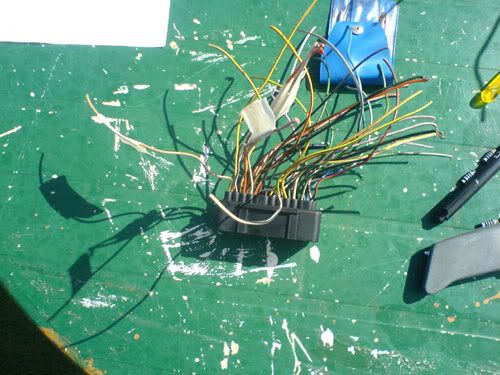

:o Nice work Shug - you don't fancy helping me sort out my spaghetti for wiring .. :wink: :roll: :(

Dinna talk to me about wiring.... I'm expecting 'nam style flashbacks
