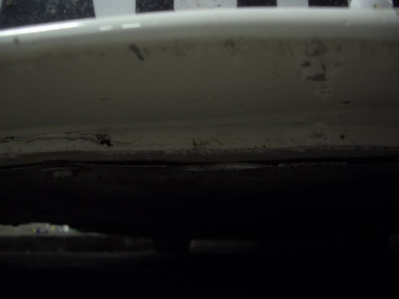

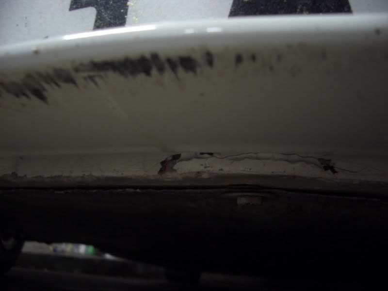

How did you get on with this ? Have a problem with the 340 now living in the land of the speed bumps and pish road. Initially I was not too concerned as I thought it was just the undertray bolts but have noticed it is increasingly teh front splitter that is taking the brunt.
I take them uber slow and feel the scrape rather than full beans and take the "hit". Thinking of some form of skid plat for the bumps to prevend the grp being reduced. Naturally the thinner the better so as not to make the problem worse.
Have contacted Carbonology.

Use stainless, as you can actually get hold of it.
A nice long strip sikaflexed on to the bottom of the splitter will save the grp and still flex with it a bit.
