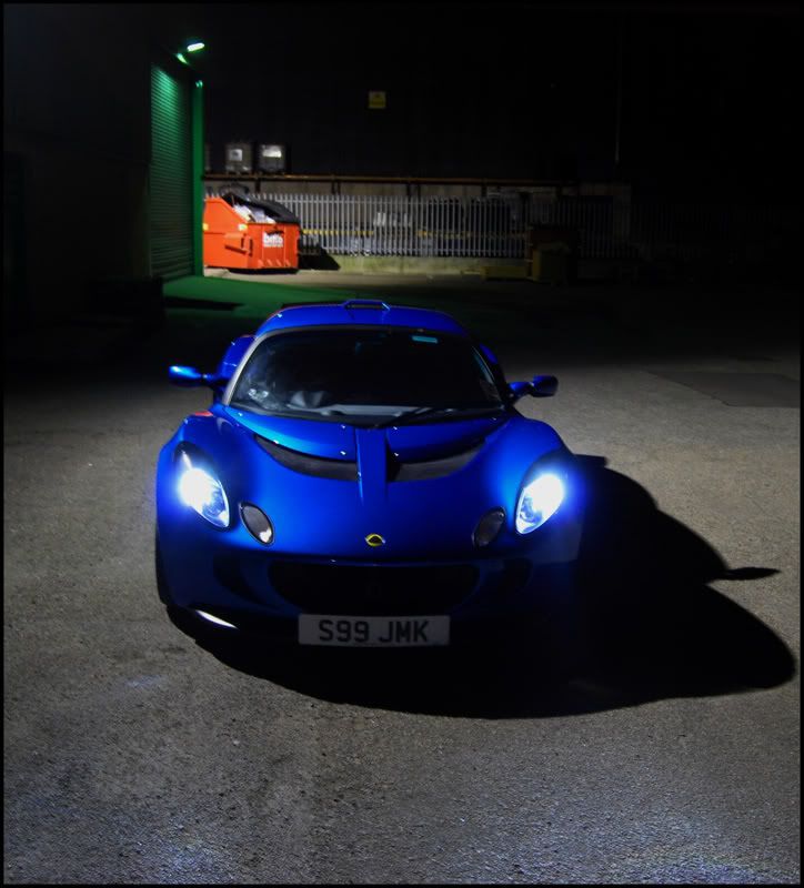

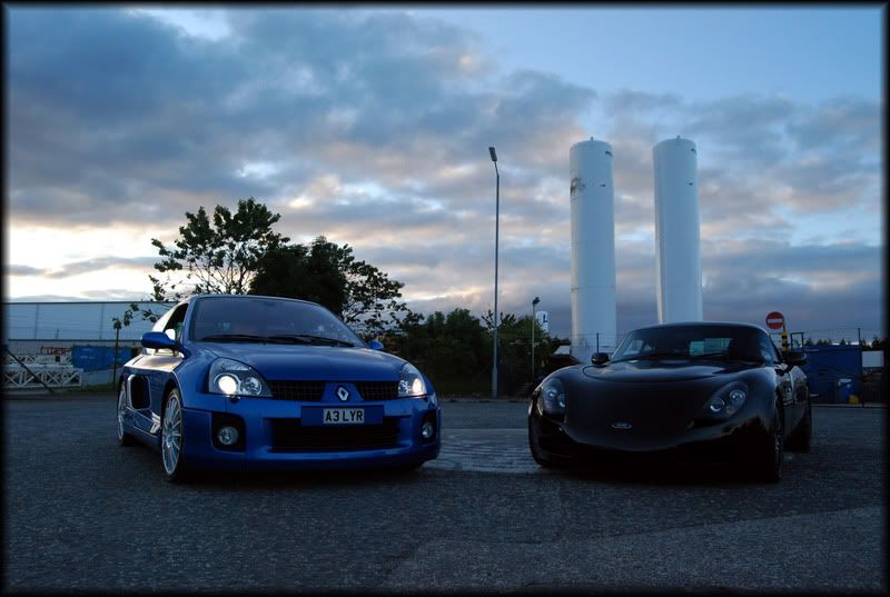

Generally, 4300k are standard Xenon colour, and 8000k are a bit chav/blue/purple.
I'd go for 4300k (whiter) or 6000k which have a blue tinge to them..
6000k -
I think these were 4300k, but they might have been 6000k

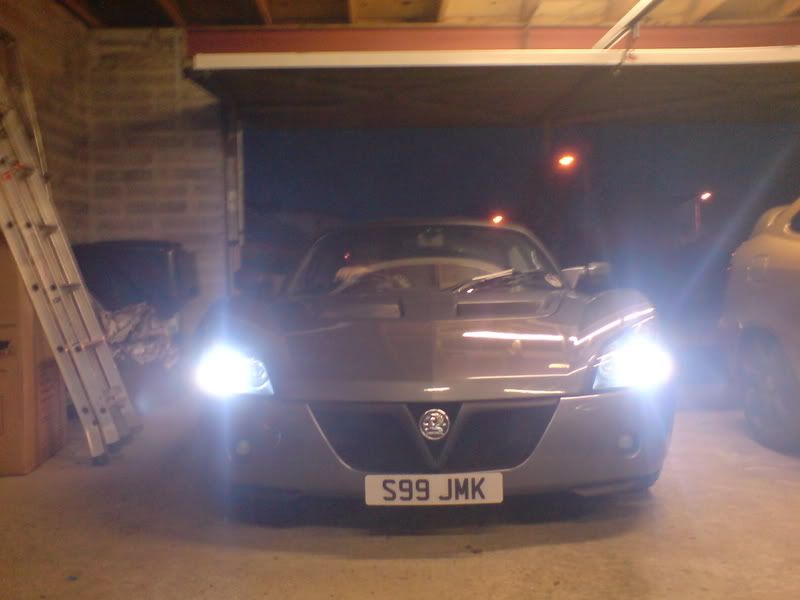

The VX220 ones ARE 6000k, and the Clio ones are the standard 4300k

Justin wrote:Generally, 4300k are standard Xenon colour, and 8000k are a bit chav/blue/purple.
6000k -
:loveing the second pic of the exige..very nice.......6000k HIDs right?

okay update on HID's
i bought and fitted some 6000k h1 bulbs from ebay..and they look great and work nice.....however, im hearing that they would be an MOT failure :roll: , due to the new rules...is this so?
:thumbsup leigh
P.S. will show some pics later
1998 Audi Elige s1-1.8t 20v
