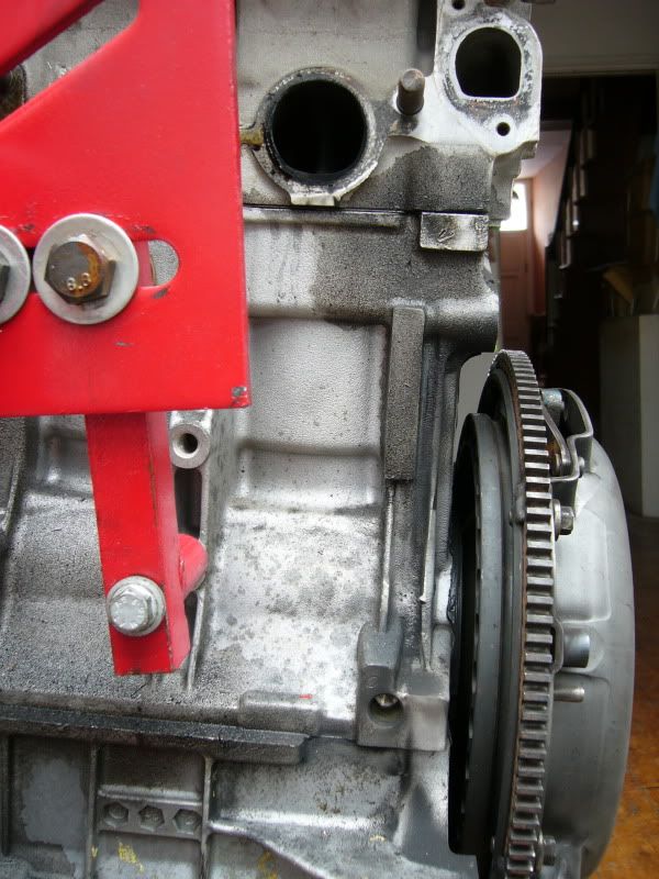

Lesser issues also -
are the crank carrier to block has just two dowels, it needs all ten
the oil rail that anchors the longbolts is insufficiently stiff and has too small a foot print
the block is open decked, like all the engines that have copied K [ including Honda K20] which has longevity and heat transfer issues.
the sump is no longer baffled, unlike the initial production Ks
there is a crank resonance issue at 7000 rpm which is widely misunderstood.
Having said that, all the issues in this and my previous posts on this thread can be overcome, and my engines after a lot of research have remedies -

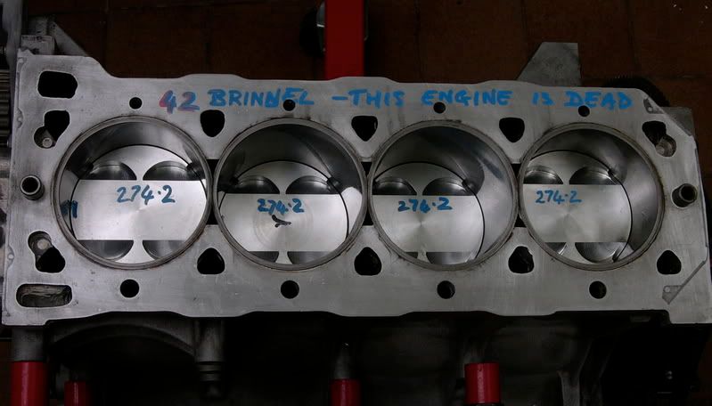

Examples -
- below is a very expensive short end built but a "professional" who considered cracking liners were caused by the open topped block. In fact liners crack because the same company had continued to use the old plastic dowels, so apart from the misguided diagnosis these people decided to close the top of the block [not a bad idea in itself - that will have several advantages] by welding it up and re-machining it.
- There lies the problem, they were careless/ill informed/just didn't care to study the engine, enough to not realise that the K unlike all other production I4s is as light as it is BECAUSE of the use of a heat treated alloy LM25, and therefore by heating it enough to weld in the inserts the very remedy they were using was destroying the treated state of the block and rendering it scrap
On this newly rebuilt short end the builder's welding had reduced the hardness of the block from 120 brinnel to 42
Unknowing incompetence....

And apart from rendering the block unsound, the metal becomes soft so the compression trim at the rear of the gasket digs into the soft metal, which causes the gasket to leak oil and water, you can always tell one of theses 'EVO4' blocks from the oil stain at either end of the engine...... an engine scrapped by the very process of modifying it... stupid, and inevitable.
