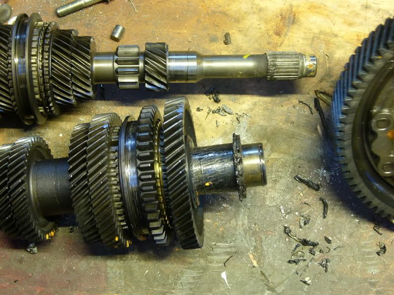

Incidental to the subject of the thread, but another reason not to like the Honda conversion, is this weakness in the 6 speed box, this out of a honda converted Elise
the honda box is actually a reworking of the old B series 5 speed box, along with some nice features like triple cone synchros, the gears have simply been narrowed to fit the 6th into the same casting. The layshaft pinion failure was common on the b series box too.
Re: Why don't I like Honda K20's
WTF should that look like?!

Wow!
