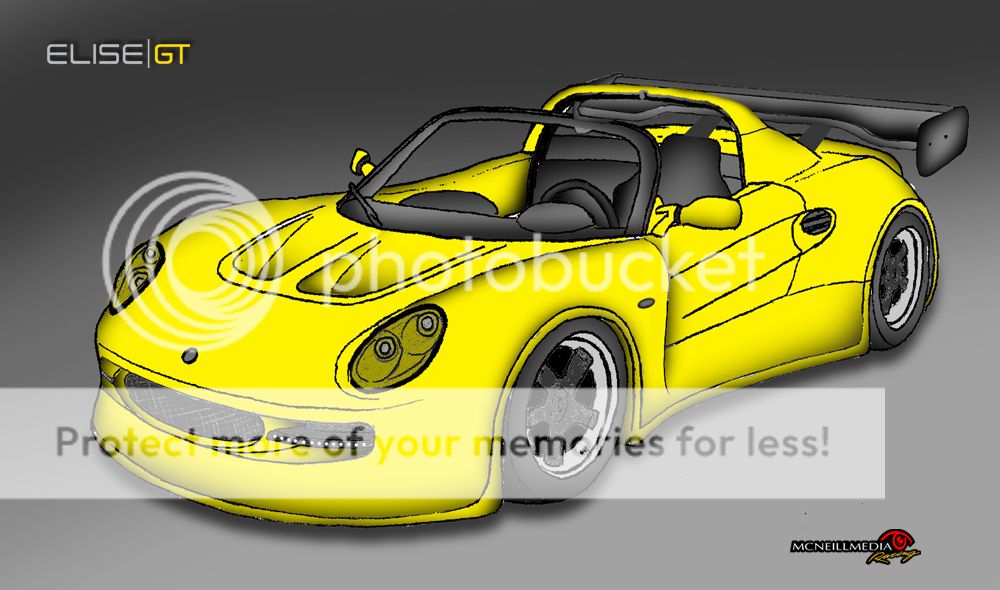

Post by MacLotus » Tue Sep 18, 2012 12:45 am
I finally made the decision to put a wing on the Elise GT, so I ordered a 67" GTC-300 from APR on Friday. Carbon fiber construction. I will custom fabricate the upright supports (which will mount to the subframe through the body) and position the wing a little lower and rearward than most wings. Should look a little like this...
Ken

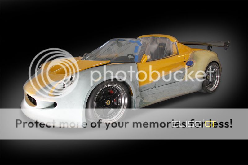

Post by MacLotus » Wed Sep 26, 2012 11:22 pm
Started to fill and block for final finish/paint (pearl yellow). Received the new APR 67" carbon fiber wing (body is 72.5" at the fenders). Wing mount brackets will come straight out the back of the car (bolted extensions direct to rear subframe). Custom wing uprights will be 1/4"-5/16" aluminum, bolted to the custom subframe extension brackets, and adjustable height (2 ft. adjustability).
This way, wing can be removed for street use, or installed at minimal height (as shown).... and once at the track raised up to the clean air.
Ken
