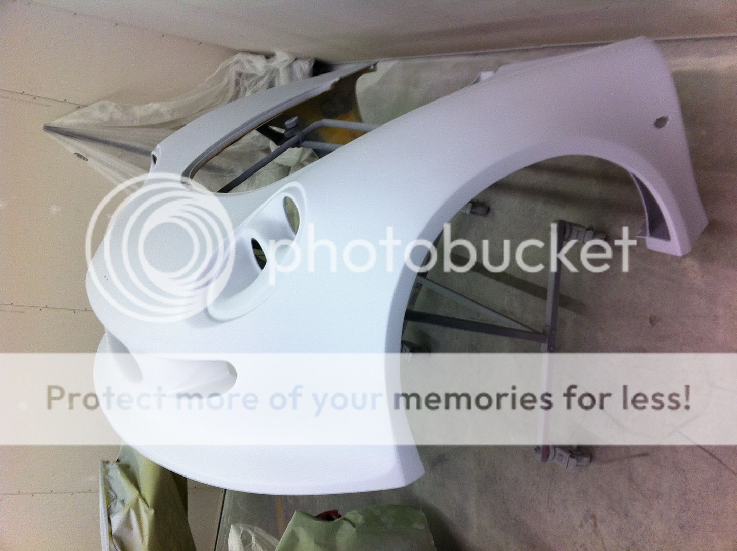

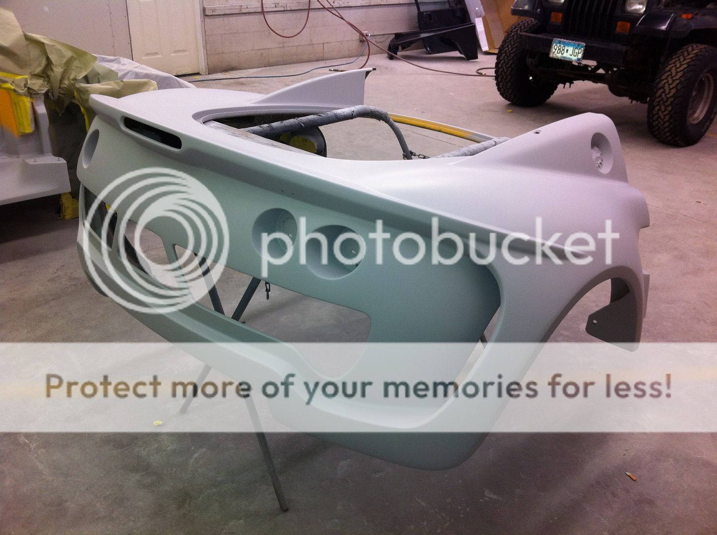

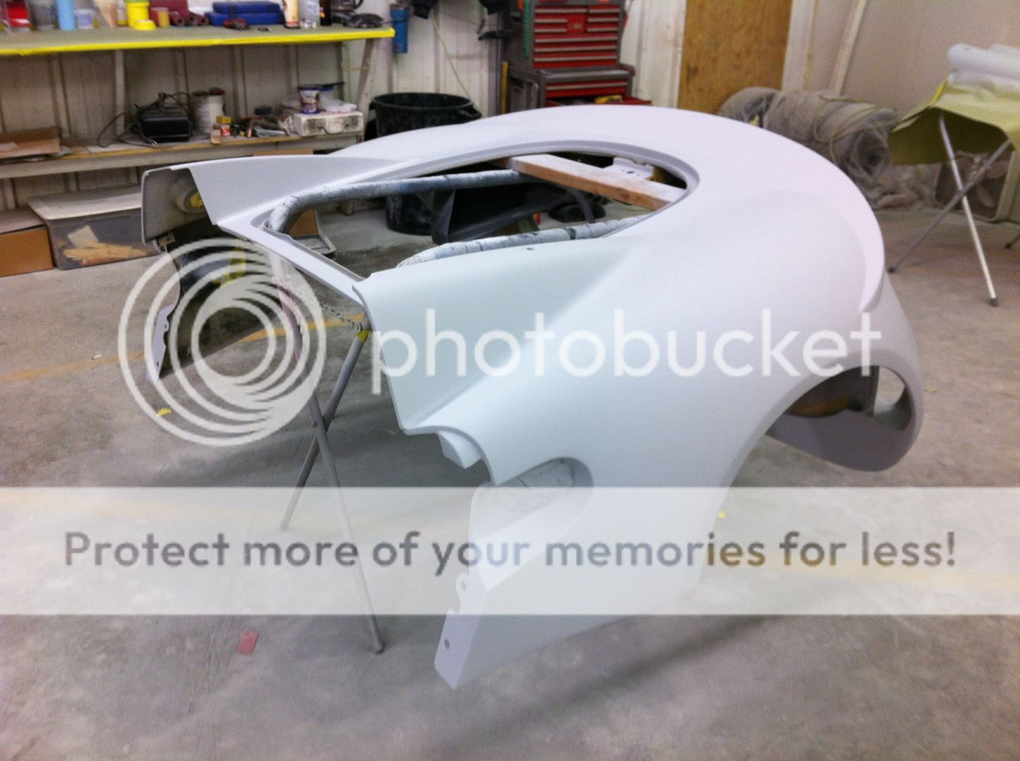

Been working on a somewhat unique and innovative addition to the project. An 'automatic' downshift throttle blip system for the Lotus H-pattern that eliminates the need to heel/toe under threshold braking. Works great in the garage, but need to try it on the track. Stay tuned for more on this.
Spraying gel coat this week. The black dusting is the guide coat.

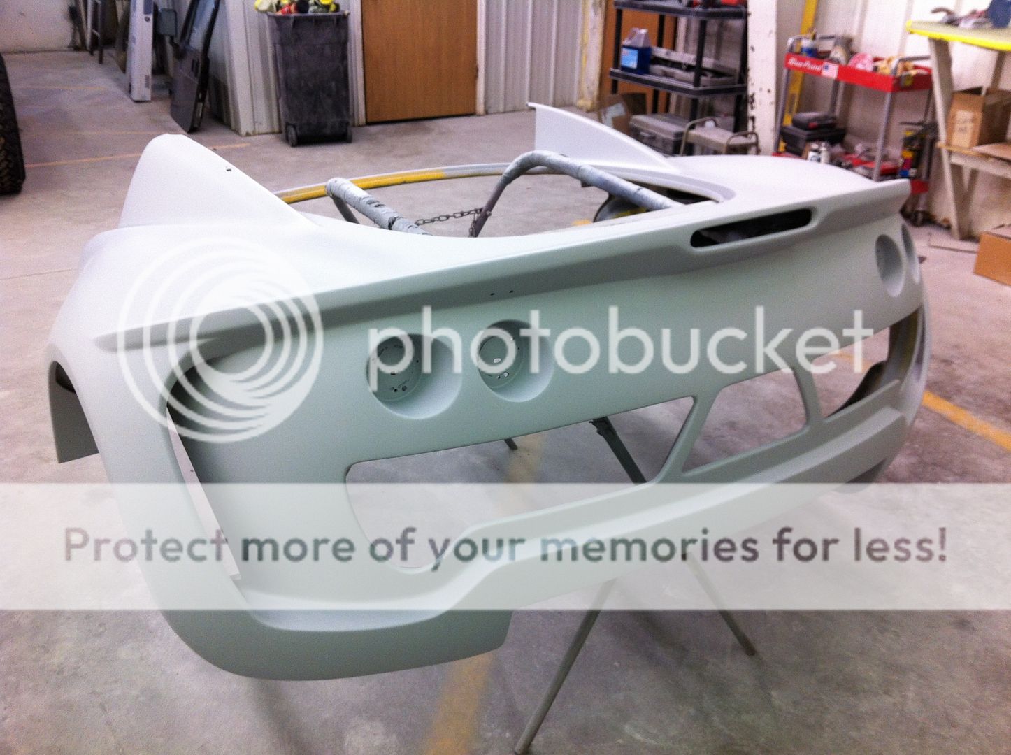

Post by MacLotus » Sun Apr 21, 2013 11:28 pm

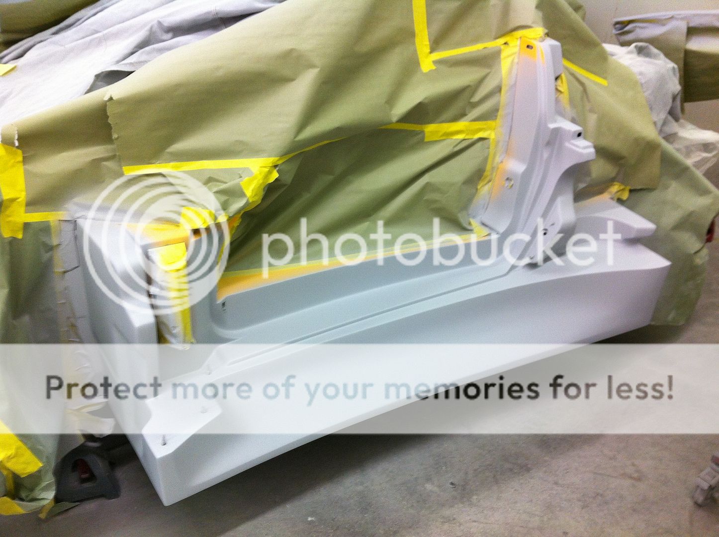

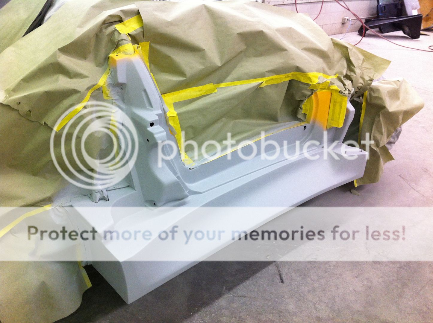

Should be getting paint this week after sitting primed for a week to ten days. The primer shrinks so its important to allow this to happen before final sanding and paint. I also decided to not go with a tri-coat pearl paint process simply because its just too difficult to paint an Elise S1 assembled (which is really optimal for even pearl overcoat, especially with yellow. Plus, it's incredibly challenging to repair/re-paint areas that might need fixing (track cars).
To that end, a two stage (basecoat + clearcoat) is much easier to panel paint and match during repairs. So this decision meant choosing a new color. Giallo Modena or Ferrari yellow is the final choice. Should look great!

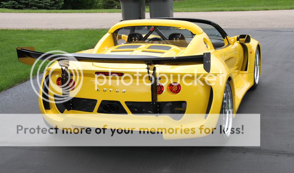

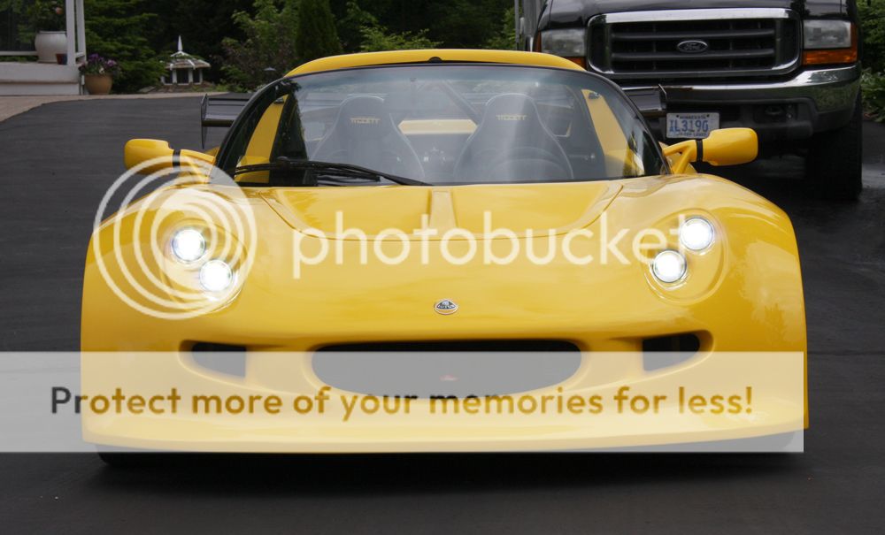

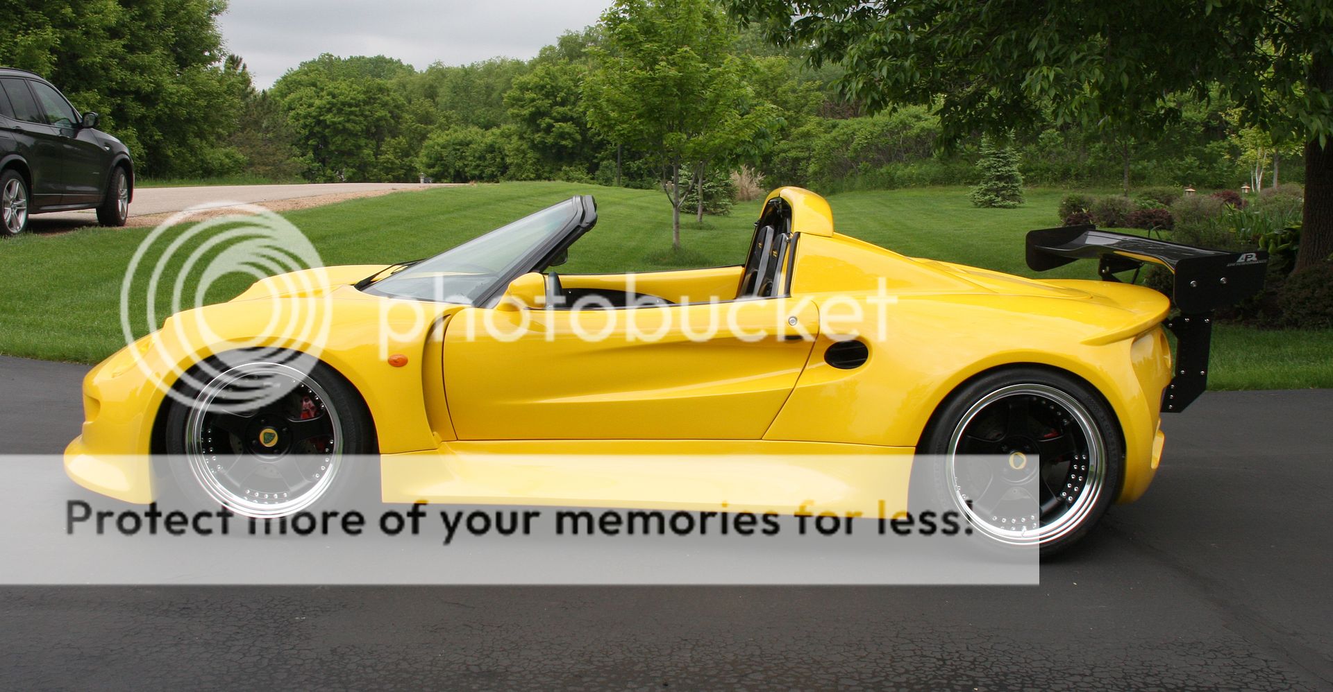

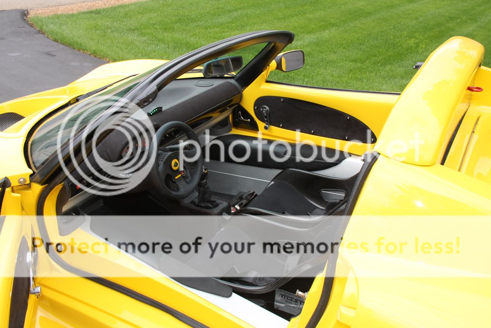

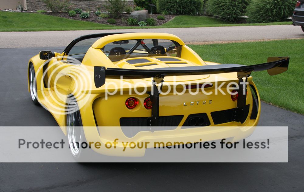

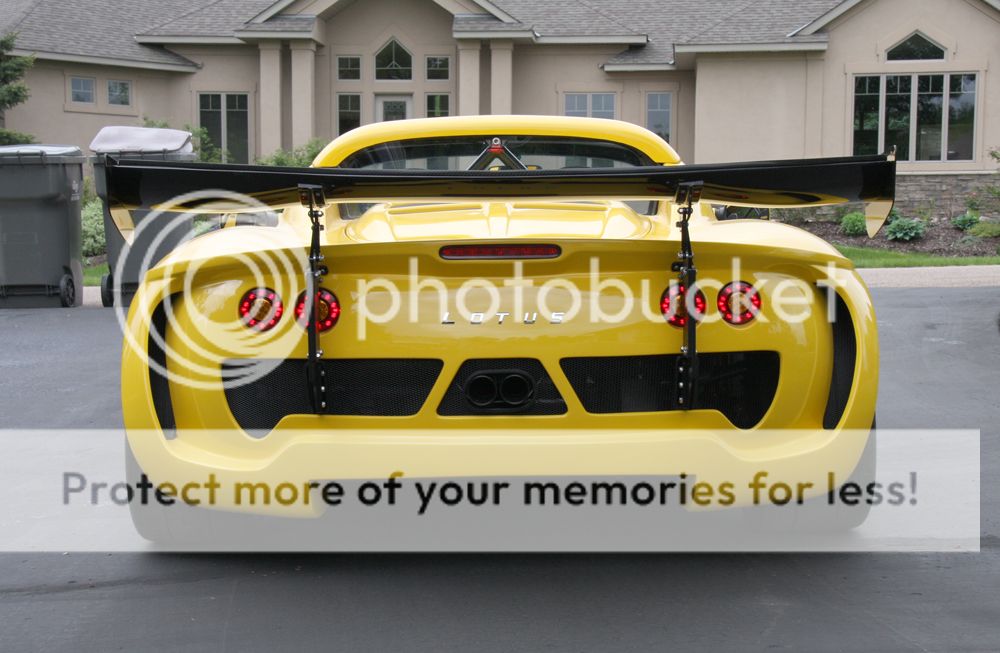

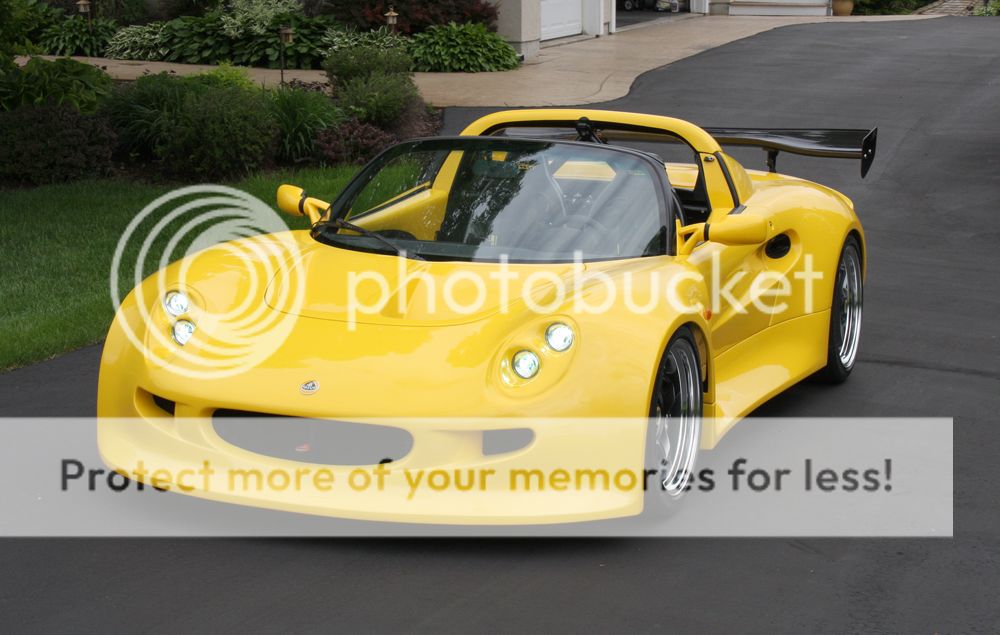

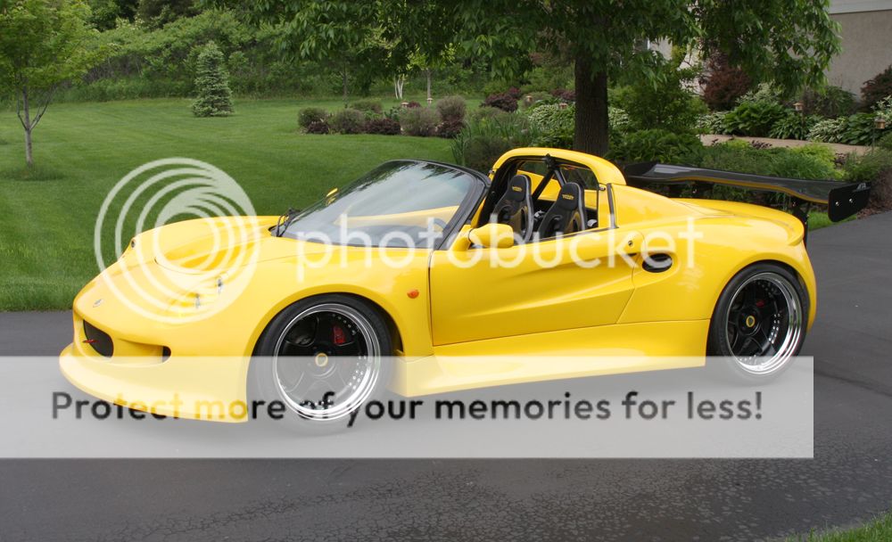

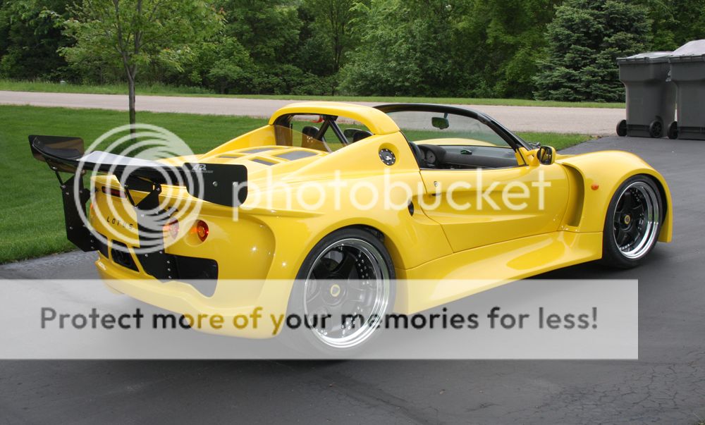

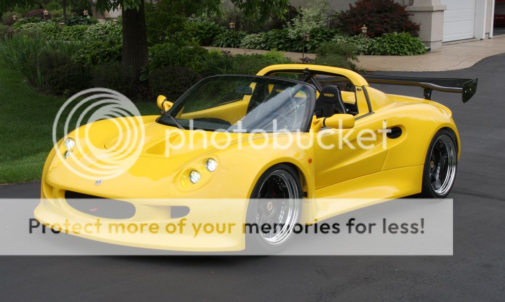

Nearing final reassembly of my widebody project. I made a change in the final color choice to Giallo Modena (Ferrari Yellow). A 3 stage pearl is just too much trouble to maintain on a track car, where this is much easier to touch up and/or panel re-paint for exact match.
I still have to install the head lamp tinted lens covers, as well as the carbon fiber airfoils in the front airvents (which also encase the LED daytime running lamps/turn indicators). I also need to install the rear air diffuser and wheel arch liners.
