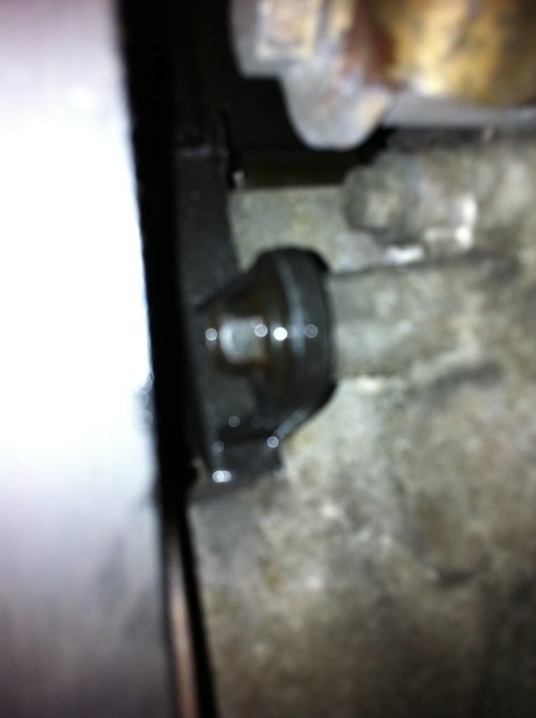

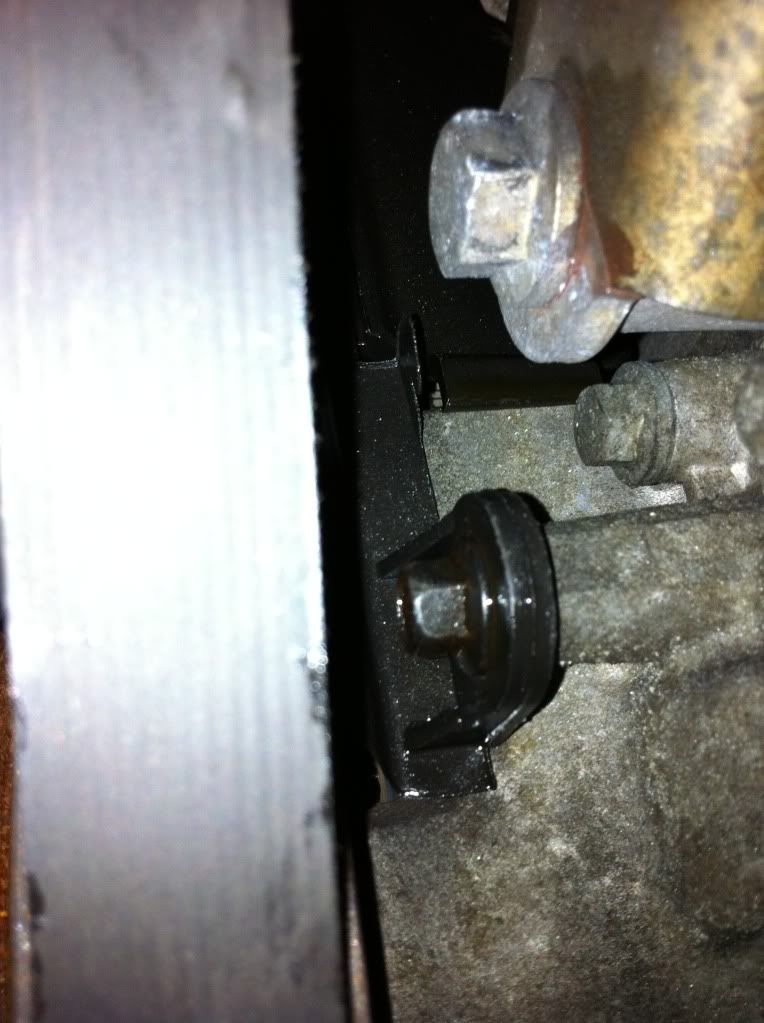

not sure if this is from when i topped up a little oil, and this is spillage... as surely when MMC had the car and replaced the alternator etc. they would have seen this
Posts: 14460
Re: Stupid question... and no I am not female ;)
Post by Dominic » Wed Jul 13, 2011 2:04 pm
A little split oil can go a long way, and look like much more than it actually is. Was there any oil drips/puddles on your driveway where you park the car?

nope - never had any drips or spotting ever - and its lock block here and an underground car park during the day most days.

Wipe it all up as far as you can and watch it like a hawk.
Oil P lamp flickering, 0.5L needed to top up and oil on an undertray sets my paranoia to 11...
Post by Shug » Wed Jul 13, 2011 2:36 pm
While you're under there, just check the sump plug is done up tight - unlikely to be that as there's oil above it, but you can get at it easily and it's a simple fix so daft not to.
Last picture, big bolt in middle of shot. Remember, lefty loosey, righty tighty! No need to heave on it - if it's nipped up and not moving, it won't be that.
Post by Rich H » Wed Jul 13, 2011 2:37 pm
To be fair at second glance it looks fresh oil, no crap stuck to it so you might have just sloshed it.

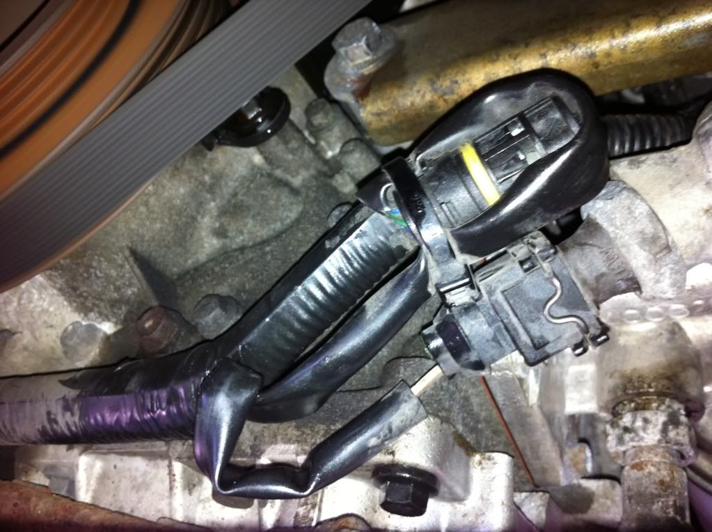

I assume this is the oil pressure switch ?
if so - I am also assuming as i can not get the light to flicker by pulling, pushing/wiggling the loom that it is not electrical -- hence if i remove the switch and start the car.. the light should be ON??
Thoughts
Oh and its def not a leak, as sump plug tight, and no other signs of oil, its just the teeny bit i sloshed over the other night
Post by Shug » Wed Jul 13, 2011 3:01 pm
Cool - nope, if it's pulled it should be off - the sensor grounds to switch the light on (I think Robin has said this bit) You're looking for any chafing in the wire that could lead to it touching on the block or chassis. Doesn't look likely from that shot TBH. It may then be a sensor on its way out.

hahaha - ok so i pulled the plug, and no light as per above info from you guys..
soooo--- in my infanite lack of wisdom i decided to remove the pressure sensor switch....hey presto, instant coverage of oil almost in the face!!
I think i will just order a new one, fit and then see how it is.
once i clean the fecking lock block!!
Post by Rich H » Wed Jul 13, 2011 3:12 pm
Do not remove the switch It'll pish oil everywhere!
Pull the connector and ground the wire and the light should come on, then wiggle the wiring see if the light flickers.

izibecoz wrote:hahaha - ok so i pulled the plug, and no light as per above info from you guys..
See you are learning fast :-)
Top marks for effort. Top tip for future - big sheet of old cardboard on the driveway before any oil operations ;-)
