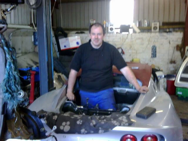

So after a long absence, progress has been made as you can see below, where Ali is pretending to be an engine :mrgreen:
Spent the whole day at SLS yesterday and got the engine out the car, gearbox off, sensors stripped off and all ready to transplant onto the rebuilt unit. As usual the car was fighting back and took a bit of blood from both Ali and myself! Ali thinks the engine will go into the car on Monday, so I should be able to try the first start shortly :)
Found a couple of bits that will need replacing, as one of the rear shocks and the exhaust flexi are "nowhere near" MOT standard...
Hopefully more to come shortly :D
