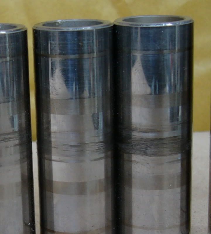

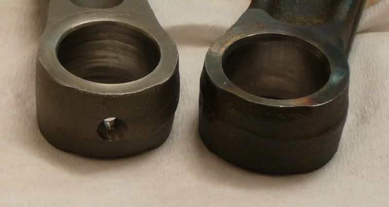

Here was a horror, aftermarket tuning of the very stupidest and worst, designed to make the engine fail
L/E stock rods really badly opened up to fit a fully floating pin for a forged piston, but not only done with no bronze bush, done out of parallel with the B/E, ie that would have caused the piston to be rammed up the bore at an angle inviting catastrophic failure. In fact done so badly that the rods hacked up the pins in short order, - this after 750 running in miles. This is aftermarket tuning of the most utterly incompetent standard in my humble opinion -

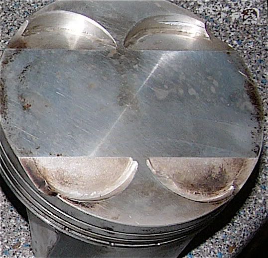

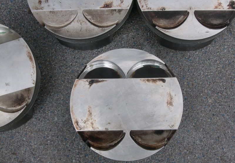

And this by the same author
piston valve pockets opened up crudely and unevenly for bigger valves, and it seems likely no valve/piston clearance test done with 5 of the 16 valves in this one engine bent -
ugly, careless, incompetent and disrespectful of both his client and the engine - and it is the latter that angers me.
it is BUILDING failure into the Rover K series, it is not the engine that grenades, it is the building that causes failure.....

Here was my effort to rescue this engine [which was wholly scrap in my view] for an owner who wanted to get some use out of it - all done FOC BTW
inlets machined out, and machined out evenly with correct clearance rather than opened really crudely, I left the exhausts as they didn't hit, but remain ugly - again in my humble opinion.
