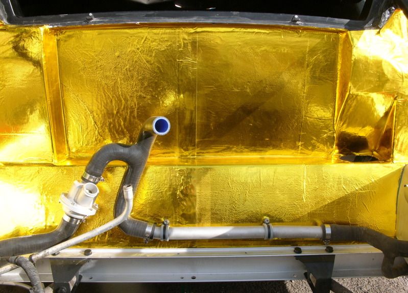

8) Reflect-A-GOLD??? that wouldn't have been cheap to do a bulkhead with. Last time I checked it was over £60 for a 24" x 24" sheet.
1999 S1 Elise - For Sale
2003 E46 M3 - Sold
Re: S2 K Series Head Gasket Has Gone
Post by robin » Fri Apr 13, 2012 8:54 pm
Looks like Aquarius :-) (Apollo 13 lunar module).
KingK_series
Posts: 567
Post by KingK_series » Sat Apr 14, 2012 12:17 pm
robin wrote:Looks like Aquarius :-) (Apollo 13 lunar module).
The baulkhead is a 9mm nomex honeycomb which not only insulates me from the engine bay better than OE but gives me space for my over the gearbox exhausts and dry sump tank location. Gold just looks pretty like the New Generation engines.
