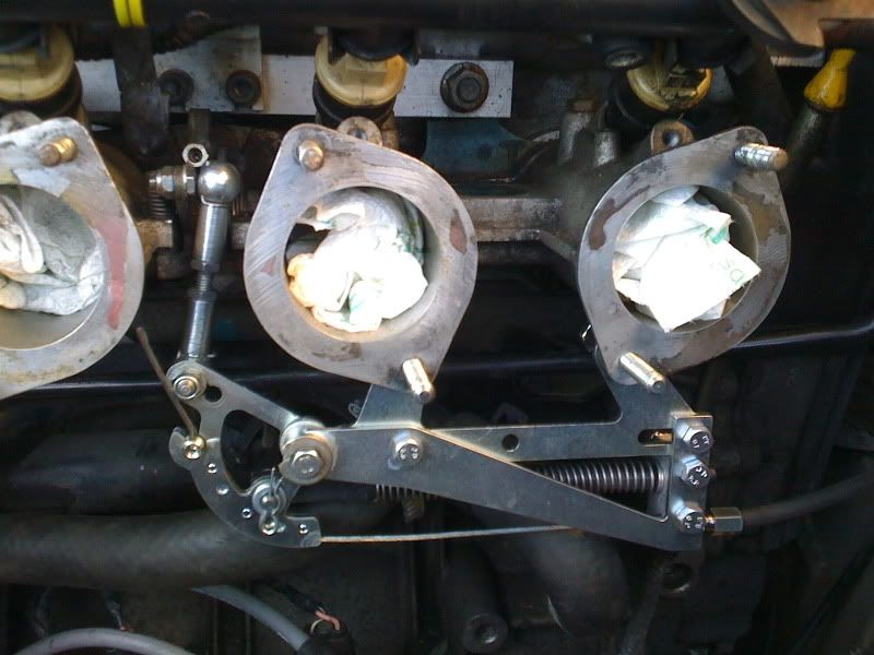

Promised some shots - so here's the throttle linkage:
and that's all yer getting as the rest were sh*t. Might modify the gearbox/chassis mount to make it easier to get off this time and show that - not much else of interest that can be taken without a third pair of hands on a camera, while it's all going back together.
