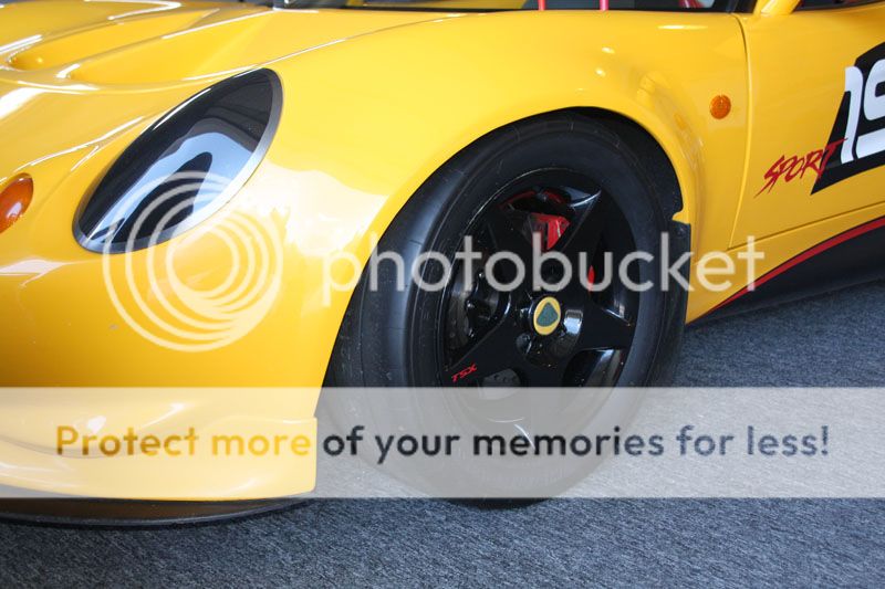

Corner balance and geo is set up for the 14th. I put the new 'meaty' slicks on yesterday (205/50's front / 245/50's rear). You can certainly tell they're bigger as the car looks a bit more aggressive. Photos to follow.
Ken

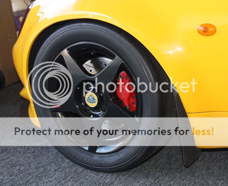

As some of you may know, the Lotus Elise Series 1 Sport 190 (European Market) has some rather unique tire sizes which can be quite difficult to source here in the U.S. (specifically the front tires). Because of the PIA factor (& cost) involved in shipping tires from the UK, I decided to try some performance track tires (DOT Slicks) in a slightly larger size. I'm posting this information primarily for those S1 owners looking a little more grip from a wider track tire. It's also my intent to post how the tires perform on the track as the Hankook Ventus slicks are rather new to the US market.
OEM - Front Tires - 195/50R/15 Yokohama Advan - (195 x 50% = 97.5mm Wide)
OEM - Rear Tires - 225/45R/16 Yokohama Advan - (225 x 45% = 101.25mm Wide)
After looking at the Hoosiers, Kumho, and Hankook's, I opted for the Hankook Ventus Z214.
http://www.tirerack.com/tires/tires.jsp ... entus+Z214
The smallest 15 inch performance tire I could source was a 205/50R/15, which is slightly taller and wider. These would also probably fit a little better on a 6.5-7" wheel, where mine is 6".
205 x 50% = 102.5mm (+5mm H - +10mm W)
After installing them, I took a drive around the block and maxed out my steering both left and right (tight U-Turn) without rubbing. I also tried some compressed-suspension turns, but obviously difficult to emulate the race track (at least without pissing off my neighbors). Still no rubbing or contact. I am running negative camber so that may help too.
For the rear tires, I had a choice between a 225/50 or a 245/45.
225 x 50% = 112.5mm (+11mm H - 0 mm W)
245 x 45% = 110.25mm (+9mm H - +22mm W)
I chose the latter (245/45) and they seem pretty darn meaty. Now I did have rubbing problems with the OE tires when running the OE Koni Dampers/springs, but that was cured when I installed Nitrons with Eibach Springs with spring helpers (500lb springs front/750lb springs rear). They never rubbed again. Now I've gone even larger, and still no rubbing... but only the track will truly tell.
I have to say, they look a LOT beefier than the smaller ADVAN's.
The car will be weighed, corner balanced, and other geometry tweaks on April 14th, so I'll post 'before/after conversion' info for those interested.
Ken
