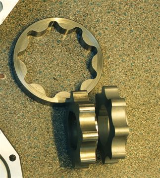

- And I don't like the design of aftermarket parts that do not follow OEM design or tolerances
- here an aftermarket steel inner oil pump
A steel pump is a useful modification to the engine for track use, - though much is written about the need for this only if the front crank damper is ditched. The Crank damper is designed to damp torsional shock in the crank - extend a cranks life, and also helps to damp the crankset resonant frequancies, this helps reduce the vibration at those two specific resonant engine speeds that the oil pump sees, but actually unless the engine sits at either of those speeds the resultant stress imposed on the pump that the damper is designed to damp is very moderate, on the other hand secondary forces of vibration are high and in a track engine these are enough to crack the sintered OEM pum.
The answer is nowever not the above EN8 pump where the lobes have been so badly formed that they soon become "wiped" in the outer pump, damaging both profiles and throwing steel debris into the oil.
This has happened simply because the OEM profile was not accurately reverse engineered into the aftermarket rotor.
