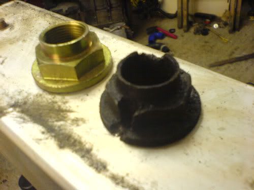

Did they come off in the end? If so how?
One of my possibilities is changing the driveshafts if the seal surface is fecked, don't fancy this at all :(
Post by Shug » Thu Apr 27, 2006 1:44 pm
RICHARDHUMBLE wrote:Did they come off in the end? If so how?
In the end (having tried the inch-drive stuff and heating with the welding plant) he had to drill the edge and split the fscker with a chisel!
Driveshafts themselves are a piece of piss, as long as you are confident enough to go postal on that nut... Bear in mind, the other one came off fine - it's just that this one had been open to the elements (missing a wheel centre cap and haven't been bothered to replace it)
