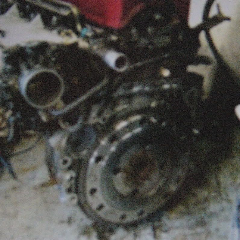

foz01 wrote: Honda updated and lightened the flywheel as part of the UK CTR facelift, so whats that 2004, mine certainly is not like that, has lots of machined holes in it although i dont have a picture of it.

but it seems very strange to me that honda have a perfectly good lightweight flywheel for the best variant the JDM which they are fitting 2001- 2006, they then fit the same to the Z1 2005 - present? why would they do something else in 2004 to the A2? Sounds like unnecessary cost to me?

They did do it, the last version of the EP3 CTR had a few extras including Lightnened flywheel, tweeked map and might also have a LSD (can't be sure of that).

Gourlay83 wrote: Honda updated and lightened the flywheel as part of the UK CTR facelift, so whats that 2004, mine certainly is not like that, has lots of machined holes in it although i dont
Alan
ok so is it better than the JDM - ie lighter? or is it cheaper and heavier?
- from the production point of view I would have thought it made much more sense to fit the JDM rather than design and make a new flywheel - true?
if not it seems unlikely to have been a lighter flywheel if they were still fitting the one I posted a pic of to JDM's in 2006?
- anyway best case I suspect is that K20A2 came down to JDM crankset weight at 29.5kg,
- still 3kg heavier than stock Rover, still not particularly well balanced and still with no dowel so it can't easily be improved.

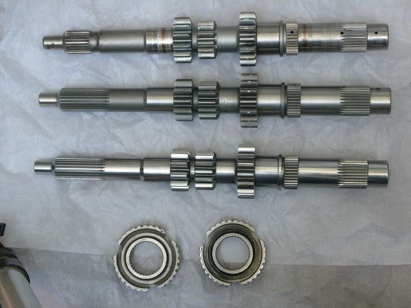

the other great thing thats included in a honda conversion is the gearbox. Proper 6 speeder, thats very reliable, unlike the quaife options for the K series, which seem to go the same way as the toyota gearbox, eating 3rd gears.
KingK_series
Posts: 567
Re: Why don't I like Honda K20's
Post by KingK_series » Wed Oct 26, 2011 5:41 pm
mckeann wrote:the other great thing thats included in a honda conversion is the gearbox. Proper 6 speeder, thats very reliable, unlike the quaife options for the K series, which seem to go the same way as the toyota gearbox, eating 3rd gears.
I totally agree about Quaife and losing 3rd has happened to me, it happens because the needle roller bearings are plastic caged [they are honda bearings and were costed down in 1996]
- which is in part why I make my own gear shafts and gears now, with any gearing. And I use only best quality all metal caged bearings
here is a pic of two of my shafts under a Quaife - you can see the brown residue from the plastic cage deposited on the Quaife shaft
There you go - a 2007 K20A2
- with the JDM flywheel, same as the one I showed you as part of the JDM crankset
so a k20A2 with this is 29.5kg, still 3kg heavier than stock Rover, note the flywheel bolts and no dowel for flywheel location and accurate balancing
sorry the pic is not great I'll try and get a better one
