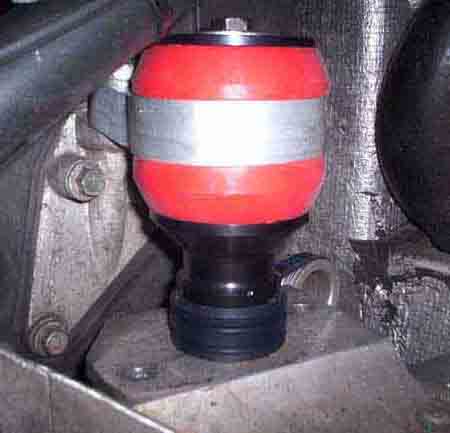

the engine mount i was thinking of was the bernard ("thunderpants" from SELOC) top mount - Elise parts does not supply this one... theres some chat about it on Seloc, but i know nothing about it other than is on there...
Maybe someone here has had it installed???
here it is...
here it is...
