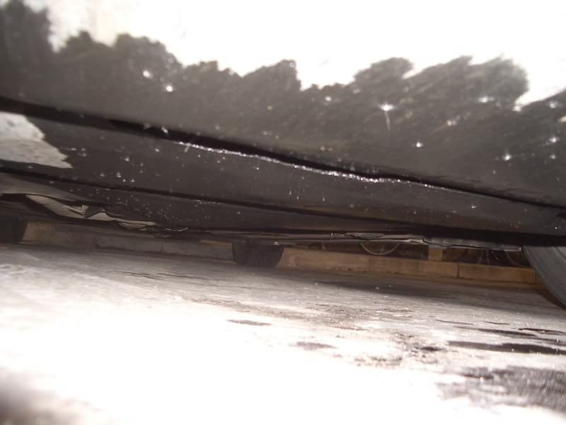

Noticed a fdew whisps of smoke from the bonnet at the traffic lights today. On inspection there appears to be some form of oil/diesel leak just under the turbo on the Merc. Looking at the undertray it may have been on going for some time as it is wet and has spots dripping down.

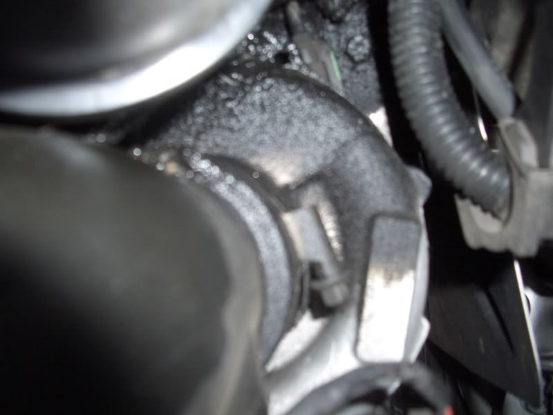

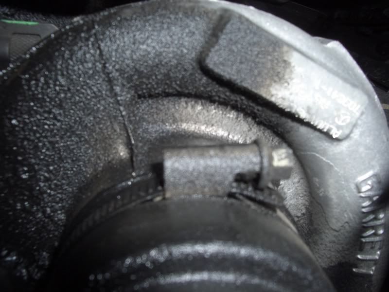

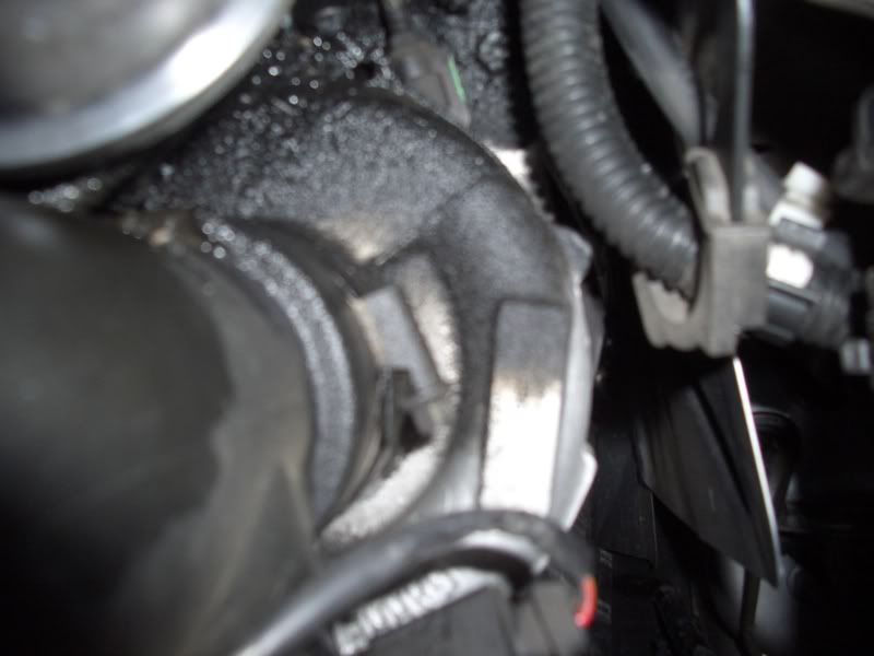

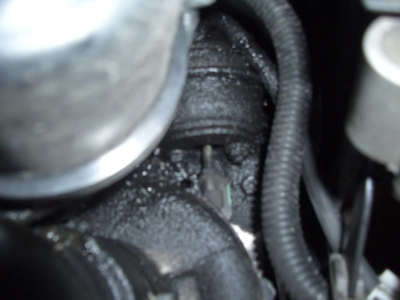

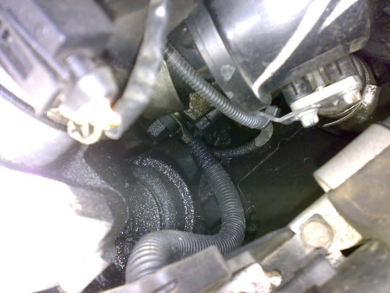

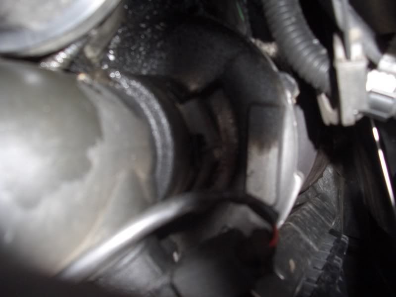

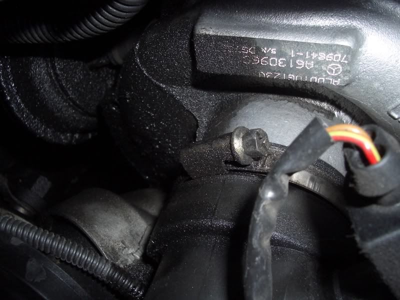

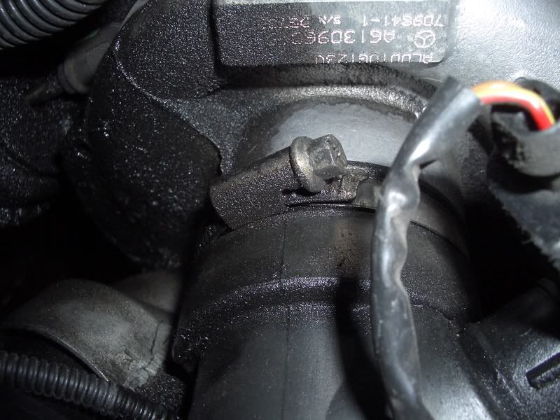

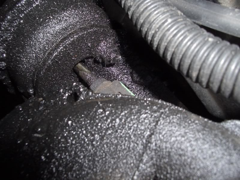

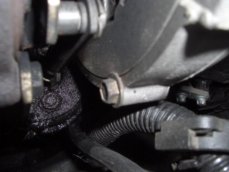

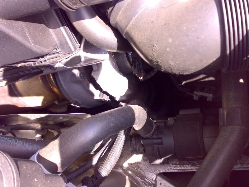

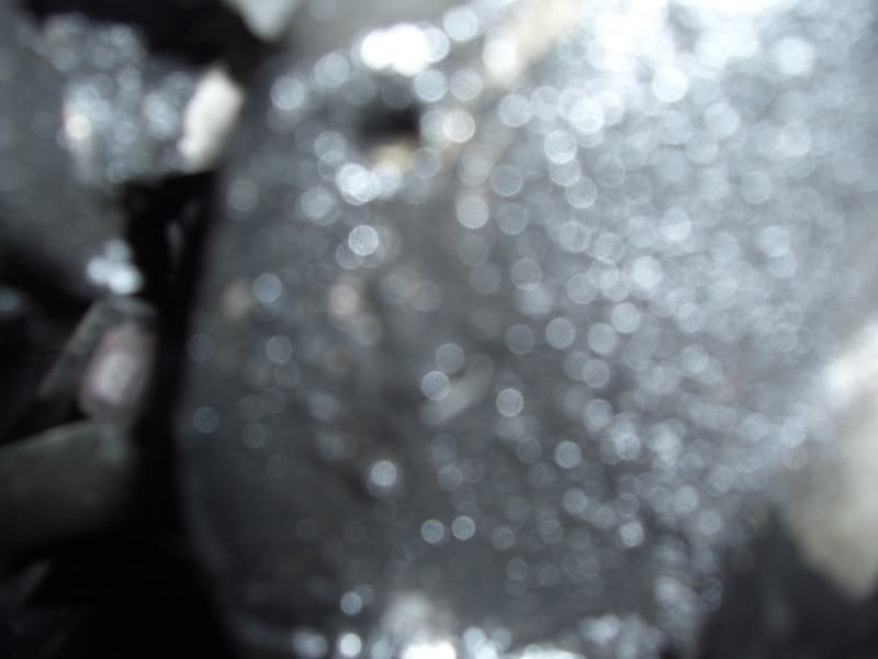

Post by Sanjøy » Tue Sep 02, 2008 10:38 pm
Some macro pics
Needs 180 rotation

Post by r10crw » Wed Sep 17, 2008 1:15 pm
We have a 2001 which I imagine is the same car and engine. I had it in bits recently and all the HP fuelines were on the inlet side to the engine not beside the turbo, have a good check over it when you get it back. Just so you are aware mate, cheers Craig. Just realized you got the car back already :oops:

Re: Oil / Diesel leak on the Merc (NLC)
Post by tuscan_thunder » Thu Sep 18, 2008 11:55 am
Possible-bearer-of-bad-news-faction:
Could be 2 problems here: the fuel lines could be one part but that definitely looks like oil in your pics.
If you can get a hose off and spin the turbo with your hand, that'd be a good idea. Does it use engine oil?
If it doesn't use engine oil and you can spin the turbo's shaft easily without any scuffing and the shaft has no play in it, I'd be inclined to leave it.
You could run a socket over everything to check things are all tight just in case
Post by tuscan_thunder » Thu Sep 18, 2008 1:46 pm
if it hasn't been using oil, it's likely to be ok.
if it is using oil, then the first thing to be starved of oil will be the turbo. You would likely notice if it was damaged as it would/should whine under load. if you're gentle with it in terms of not revving it hard when cold and letting it idle for a wee minute after a hard run it will likely be fine.
