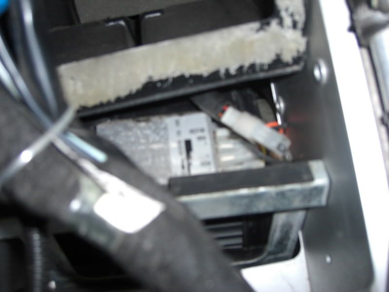

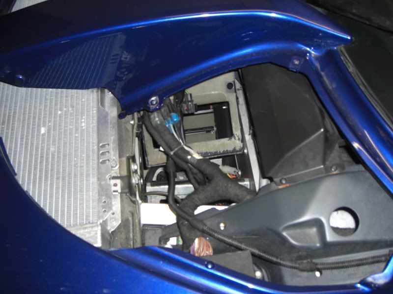

I got access to the resistor pack on my car today without the clam off. Turns out its clean with no corrosion .
It took an hour to get access to the fan resistor pack and an hour and a bit to get it back in position . The only hassle is rotating the fan to get to the pack .Slacken the loom and take a couple of bolts out to get the heater unit up out of the way . I struggled to get it back round due to the heater unit getting stuck and there being no space , a firm hand did not work . You have to lift the offside end of the heater unit into the gap in the chassis and hey presto it fell in . I did use a wide variety of swear words and called my car a **** several times .
Watch out there are loads of sharp edges down there .If you could get the fan out and back in first time it would take half an hour each way excluding the resistor pack .
I took a couple of pics but they are poor. First one is heater unit turned up to rotate fan.
