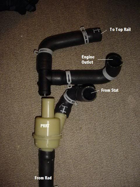

I was going to leave most of the pipework alone. I was going to put a T piece at the engine outlet. A quick scetch of the plan:
[Edit the PRRT outlest are actually the other way around, forgot to check :wink: ]
This will flow in exactly the same way as the other examples I have seen plans for and there is plenty of space, nothing will have to move. The only thing that might need modifying is the ali pipe form the rad might have to be cut down as I'm not sure the kit has enough hose included to remove it completely.
Anyone see a problem with this? :scratch The only problem may be bleeding it but that shoudl be all. I'm goign to try and get the PRRT mounted vertically to reduce the amount of trapped air, but it's down to the pipework I have really.

Only thing I'll mention is that the PRRT has a "jiggle valve" to aid bleeeding, which only works when it's vertical. (ie. not installed like mine, or yours will be)
That said, I don't see any problem - will just involve bleeding once more when it's up to temp and open, at worst.

This may help explain in place of my crappy sketch:

Ah so - should work admirably if all the pipes end up in the right place :thumbsup
