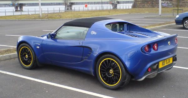

Post by simon » Tue May 02, 2006 9:04 pm
Here it is standard:
then at the comical 140F, 150R:
and the finished setup, 120F, 130R:

Post by mac » Wed May 03, 2006 7:54 am
Have to say the wheels do look good on your car Simon.
I'm also very impressed as I didn't have you pegged as a techy type person for the elise, but I'm obviously wrong. How else would have thought about pro-tech, found another member who uses them and got a base setting for Mark to work to.
:wink:

Actually, I couldn't get any more camber if I tried at that ride height.

I am happy with them Stu, it was just the cock up with the springs that annoyed me as I'd sold my old ones to Scott so I was stuck with that silly ride height! I'll need to play about with the damper settings and see what effect it has as I've only really tried 2 settings so far.

looks great! Do you still have your old wheels?

looks unbelievably low in the flesh!

The_Rossatron wrote:looks great! Do you still have your old wheels?
Yeah, keeping them for the road as I don't see the point in using 48s on road. The AD07s are good enough and offer plenty of grip on road.
