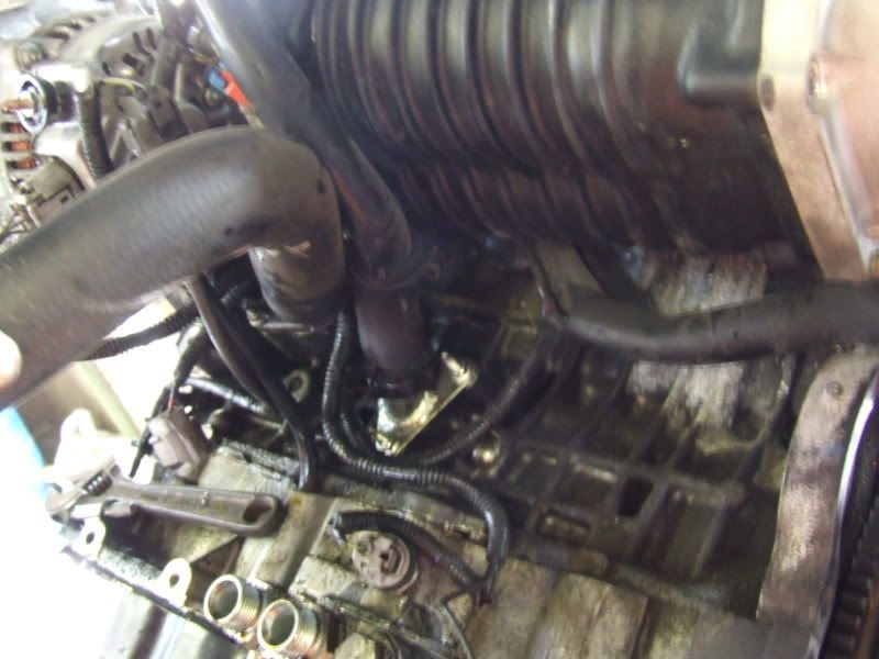

Ok, so I took my engine out last night (4 hrs due to the hinged clam
) and its def the 3 bolt plate thats leaking, Ill take pics tonight and get them posted tomorrow for you, cheers Craig.
Hairdresser at heart.
Re: Newbie technical stuff
Sorry for the delay but in the centre of this pic you will see a triangular plate, its this which is most likely leaking, cheers Craig.
