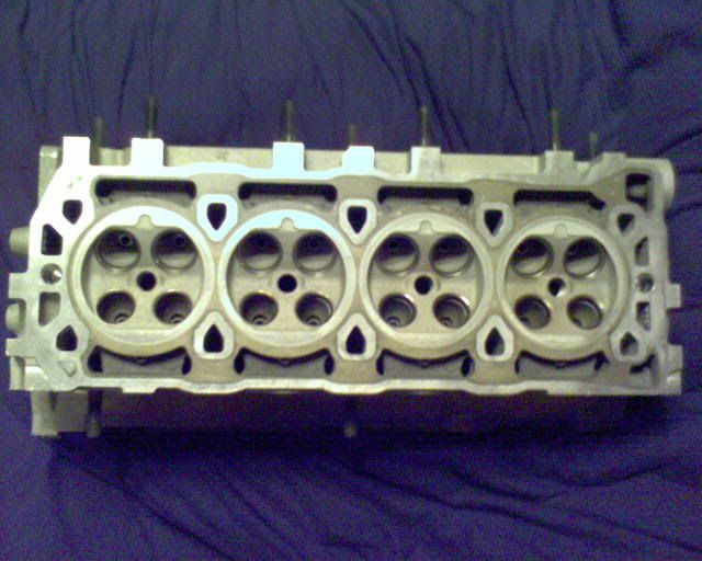

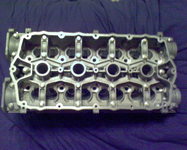

For those who didn't see my post earlier I have bagged a bare K16 head for £20.50 + £10 P&P
I bribed the guys in the paintshop (8 cans of Stella) and they bead blasted all the crap off and it's mint! No visible cracks and totally flat. No digging in round the liners and no obvious problems! I'll dye penetrant test (Crack test) it if I can find the right stuff (I may have a way of getting it x-rayed too, investigating) Yay!
Now the question is what to do with it. If it wasn't perfect then I would have a crack at porting it, but as it looks like it is I'm considering asking Mr DVA to have a look....
What do you all think? Worth the cash or waste of money?
Rich
PS They can bead blast any small (Probably head/block sized) component for a suitable bribe....

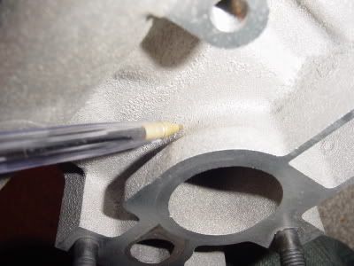

Rich
Can you do a piccy of the top of the inlet flange straight down.
ta

Post by Rich H » Mon May 29, 2006 10:15 pm
As requested :wink:

Post by Lawrence » Mon May 29, 2006 10:24 pm
sorry I meant looking from the top or rather to see the amount of metal there is between the inlet face and the main part of the head IYKWIM

Post by Rich H » Mon May 29, 2006 10:49 pm
I think I know what you mean, it looks the same as my current head:
I am very interested in theose tapes now I have a head to play with... (Assuming it is a high port!)
